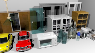

pencilart
Joined: Oct 2, 2007
Post Count: 188
Re: Sweet Home 3D 3.0
Looks Purrfect now! :D
Heeere's another one, this time with the glass door cabinets and I used a blue light too:
[Edit 1 times, last edit by pencilart at Oct 5, 2010, 5:47:28 PM]

No, the developer of SunFlow finally helped me to add support for transparency and transparent textures. By the way, again many thanks to him!
Fantastic news, maybe SunFlow does have a future after all! smile
stronger glass colour, maybe a bit too strong?
It's the contrary: their color was too clear before. If you compare to the OpenGL view the glasses you show, you'll see they are supposed to be really green.
I did and here are the results.
Knowing that there can be subtle differences between graphics cards and driver colour representations, I tried to do a tougher test as possible.
As an extra note, my screen is colour calibrated and I'm using an Nvidia graphics card.
