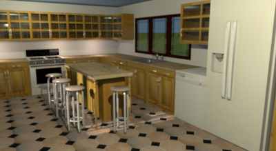

Posted by pencilart at Nov 18, 2010, 4:05:13 PM
Re: Sweet Home 3D 3.0
When I opened this beta version, 4 recovered files came up. I just closed the first 3 that I didn't want then I kept the one open that I wanted to work with.
Will it be doing this by default when you first start it up? The files it recovered were, I think, simply closed because I was done with them.
I played with the lights some more and found that I was able to turn on the already existing lights. Anyway, it's much better looking now.
Nice work Emmanuel!
Attachment kitchen-beta16.png (357461 bytes) (Download count: 812615) (kitchen with new lights)
Attachment SH3Dkitchenbeta16lighting.png (167380 bytes) (Download count: 3597444)
Attachment kitchenlights-beta16.jpeg (176281 bytes) (Download count: 816834)
