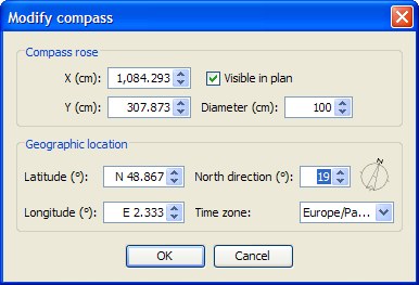

- The geographic location, the time zone and the North direction are set with the new compass that you can display in the plan as a rose.
The North direction, the location and the size of this rose can be changed with the mouse or with the Compass dialog displayed by the menu Plan > Modify compass….
This dialog lets you change also the geographic location, the time zone and whether the rose should be displayed or not.

Hans, the visibility of the rose may vary from a home file to the other. Use Plan > Modify compass… to make it visible or not. Note that it's drawn first in the plan, so it may be hidden by furniture.
I won't put compass settings in preferences because a user may want to display the compass at a different location in each home, and the geographic location of a home will generally vary too.

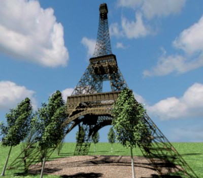

I just released the version 3.0 Beta 2 with two bug fixes:
- 3D models that use fully opaque PNG textures aren't transparent internally anymore. This should fix a few cases like this one when some transparent objects are in front of each other.
- SunFlow now supports transparent textures as the following image shows. smile
(the Eiffel Tower Collada file comes from Google Warehouse)
