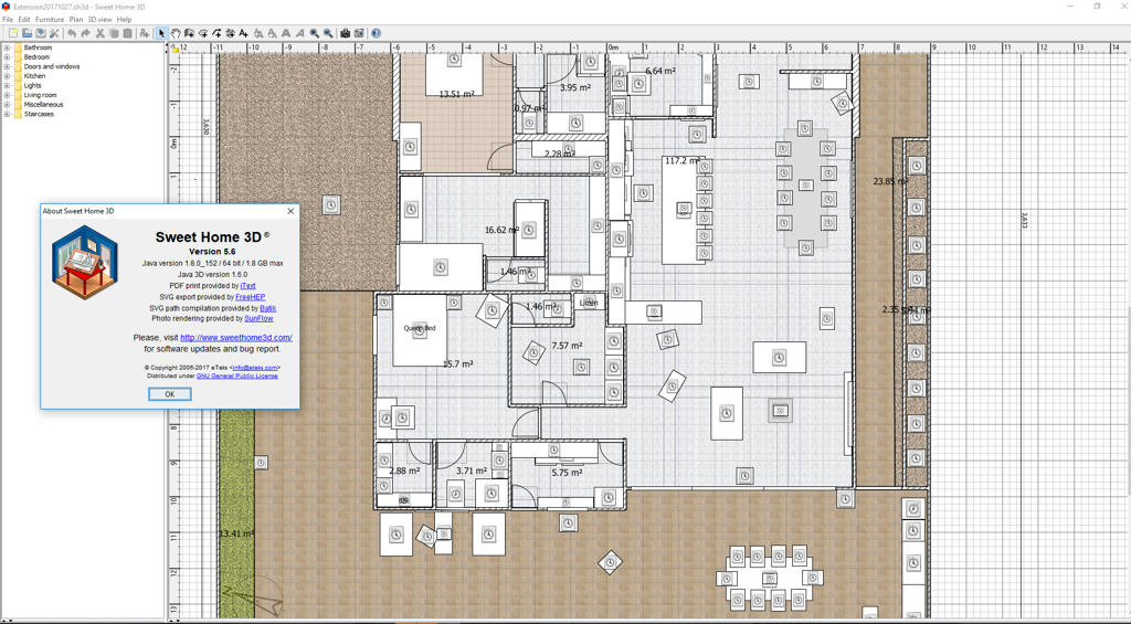

GWatson
Posts: 3
Joined: Fri Jan 12, 2018 3:31 am
Country: Australia
Re: Sweet Home 3D 5.6
Post by GWatson »
Hi Puybaret,
Thanks for the reply.
I mean when I load an existing plan and the placed furniture images are just rectangles. Slowly over like an hour, the correct furniture images load.
How do I attach a screenshot as your image attach requires a link?
Thanks
