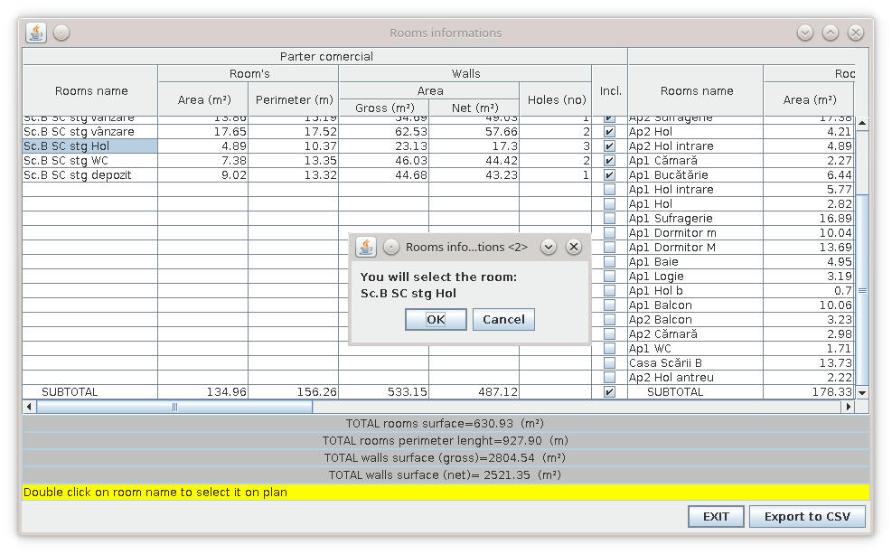

New version 1.2
It look like that:
Hope You could see the news.
Advise: Don't trust it! Verify.
BUGS:
In some cases the number of holes and walls area are not correct.
It depend of how accurate and the logic of home building.
