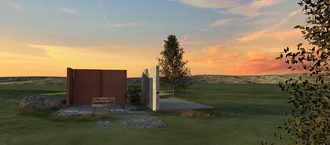

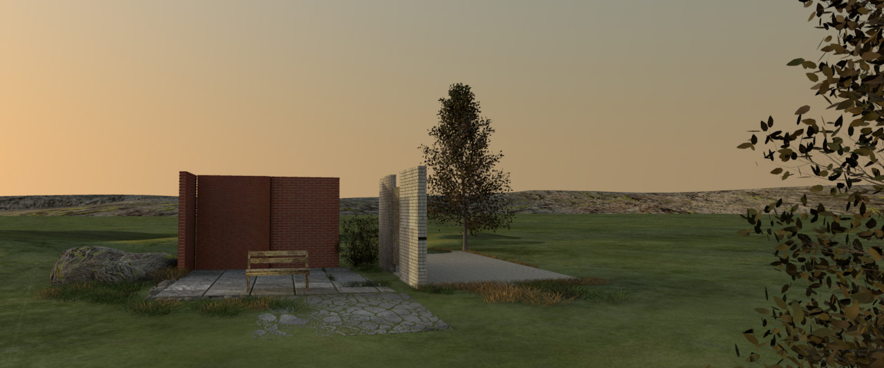

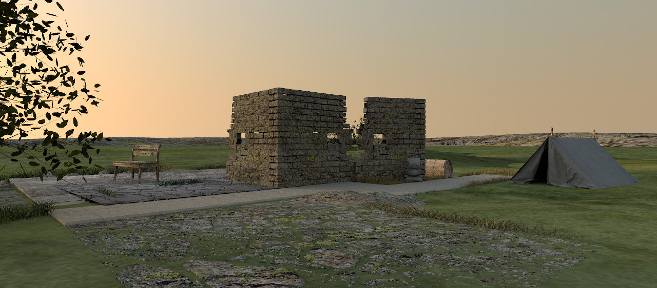

MORNING
A morning shot with Sun Sky
Same shot with a textured nordic morning sky.
DAY
A day shot with the default SunSky:
Same shot with a textured sky ( nordic sky)

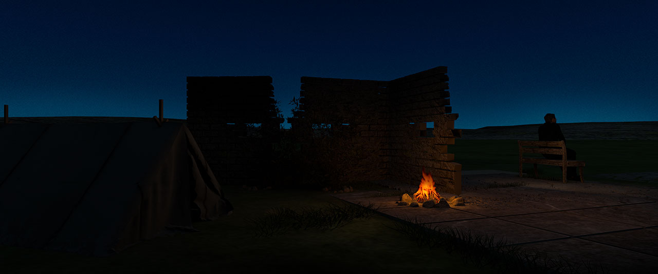

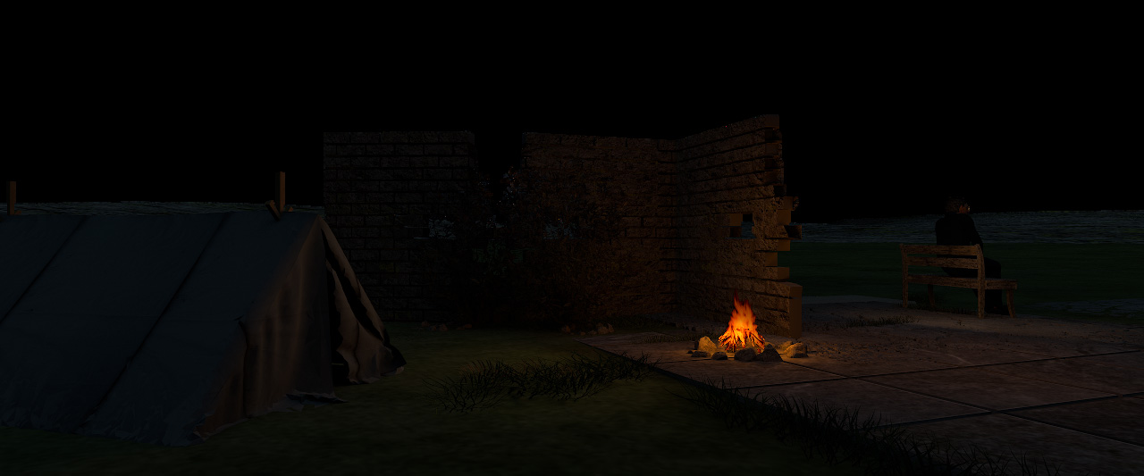

NIGHT
A night shot with the default Sun Sky
Same shot with a textured nordic blue night sky
Are there any significant differences in rendering time between these renderings?
No, not any significant differences; normally just a few seconds – maybe a minute when using very large sky textures ( 6000 x 1500 px and upwards).
