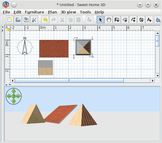

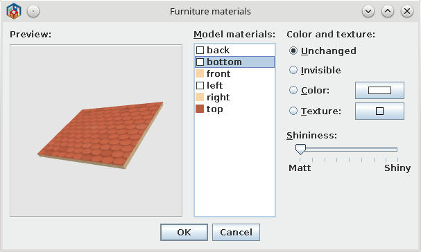

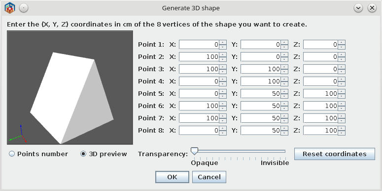

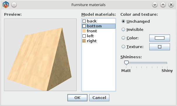

I want to show some tips:
1. Triangular prism
Some explanation:
-On Shape Generator set to pair of points at same coordinate.
In this case I chose 5+8 and 6+7.
-In plan, select the generated shape and open Modify furniture - modify materials.
- As You see in second image there are 5 sides in place of 6

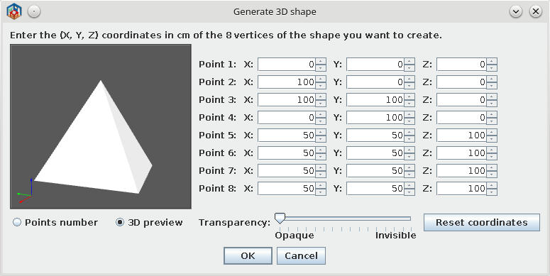

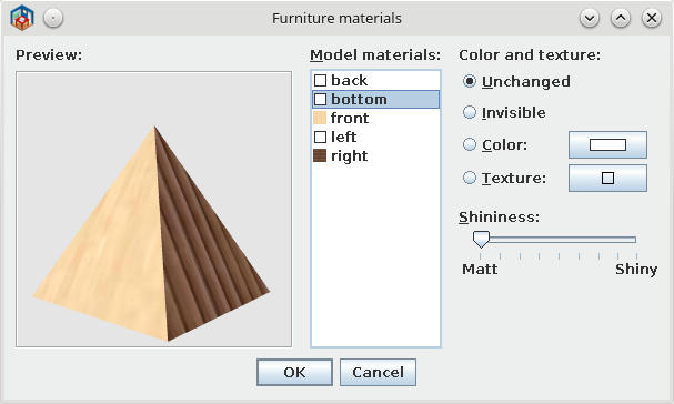

2. Pyramid
-Same procedure but for 4 upper points.

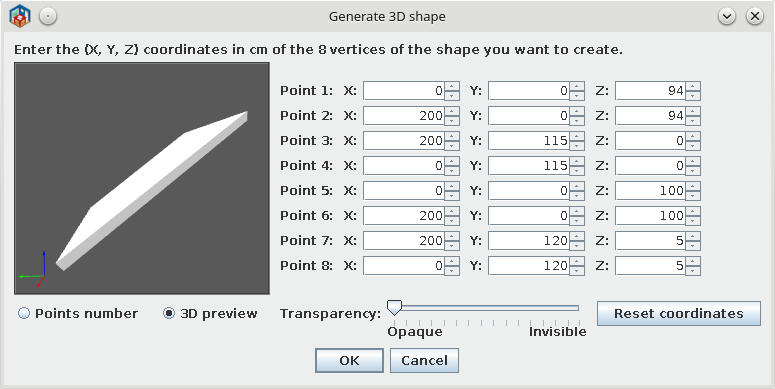

3. Roof part
-Make more and combine in plan.
-I recommend to apply texture AFTER resize the shape (if you need to resize)
And this could be this sample
Hope to be useful to somebody.
