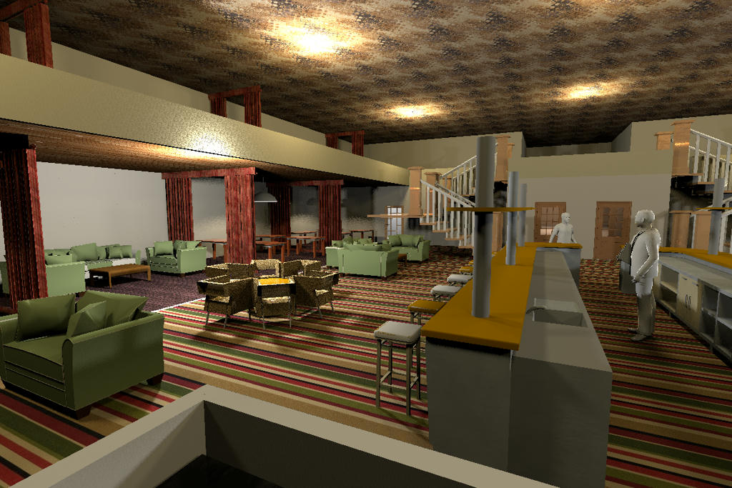

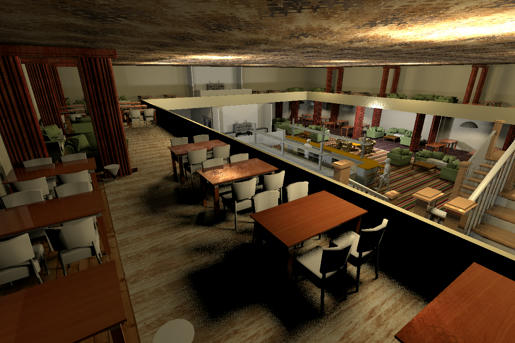

Below is a picture of a fast sketch design I made: a restaurant with a gallery. Just to show you that it is possible to do this with SH3D.

Thank you for the compliment. Here is a newer and much larger version.
click here for even larger picture

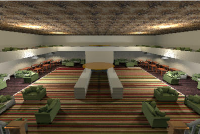

EDIT
And here is another large picture
