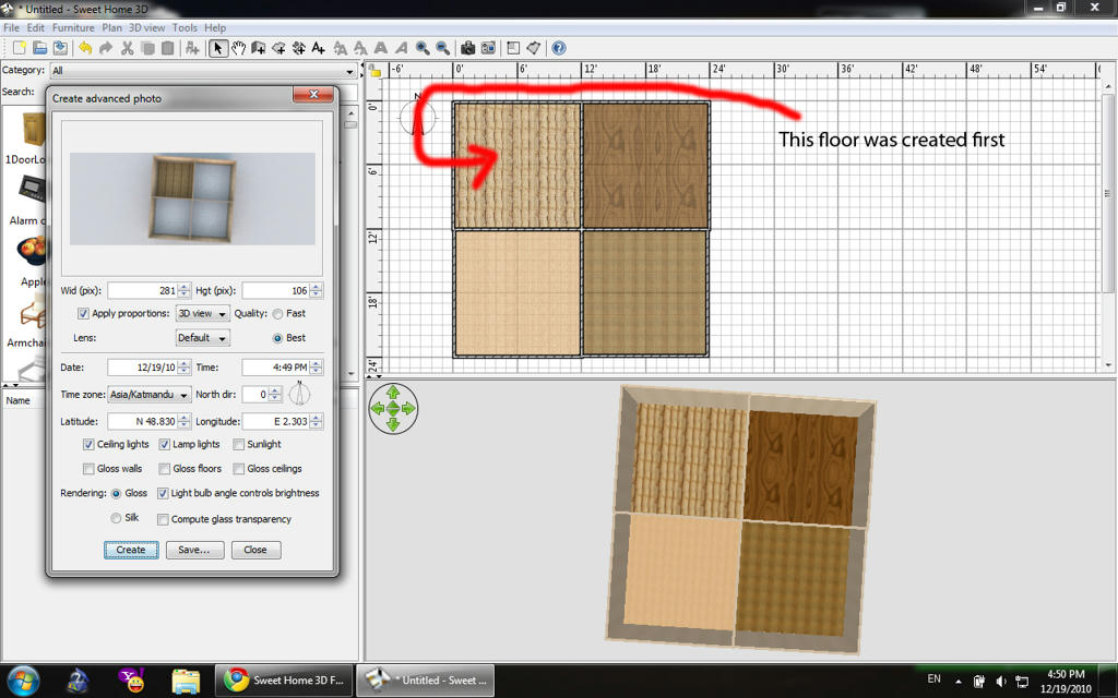

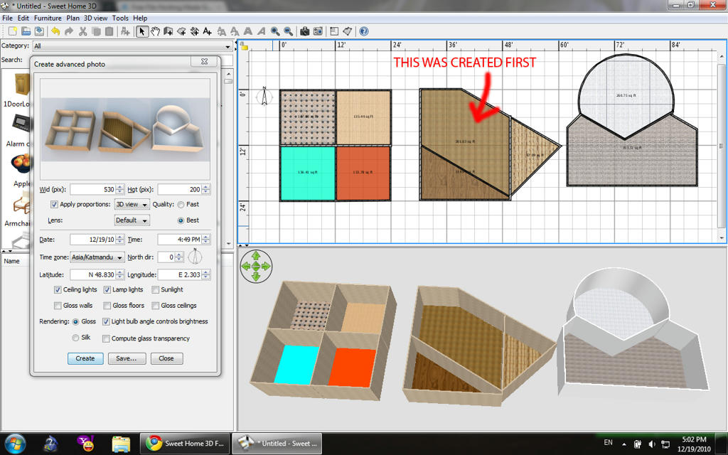

Hello! friends Here is a problem i observed,The problrm is about creating floors. if a single floor(room) is created for whole house then it appears while rendering but if diffenent floors are created then only the floor which is created at first is seen while rendering
I dont hink i explained well so here are some pictures to show what i mean
IN THIS ONE I USED COLOR/DEFAULT TEXTURES/USER MADE TEXTURE

It's probably the same problem as macfrog. I never saw it happen yet. Can you send me your wrong SH3D files please?

well this is a file i created in 5 min to show you guys and any model i create shows same problem.
Yup it is same problem as MACFROG. First i thought it was some thing he did but i tries it and when ever i make models shows the problem.
@HANS: This problem is same if i create room in other places at first only that room shows floor .I dont think its is pixel problem hans because when i use default textures only also then there is the same problem and if i create first room using user texture then the rooms will show texture while rendering...

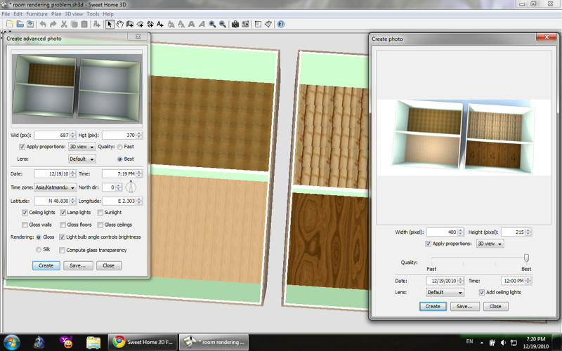

Too bad, I don't have any problem to render the file you posted at the 2 best quality levels. If I can't reproduce the problem, I won't be easy to fix.
From you screen captures, I see you tried to compute the images with the Advanced rendering plug-in. Could you try with Sweet Home 3D default photo creation dialog? I don't think it will change anything for you, since macfrog used this dialog too, but who knows what can happen with furtive bugs?

@Puybaret: May be i should have told you before that the rendering with default photo creation dialogue works perfectly in any quality mode.I am having problems in advanced rendering plug-in.
