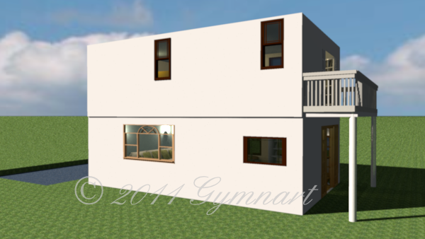

Posted by pencilart at Nov 18, 2011, 10:59:22 PM
Re: Sweet Home 3D 3.4
I tried out version 3.4 Beta 18 and so far, I love it!
Once I got "the hang" of things, it's really fun to play with! :D
A render of the kitchen area:
http://i64.photobucket.com/albums/h186/gymnar...rsionsh3d3-4Beta19web.jpg

I have a question about putting stairs in: When you put them in, shouldn't they punch a "hole" in the floor above, or below them like windows and doors do? But I know you'd have to be able to tell SH3D that the stairs start on floor 0 (and therefore no floor hole is needed) but for them to punch a hole in the floor above to get to the 2nd floor and if another set of stairs is placed above that, to punch a hole in the floor above that to get to the 3rd floor, etc.? I hope this is not too difficult.
I thought you had an icon for adding levels. Where did that go? I hope you won't be taking that out for the final version.
P.S. I made a balcony with a floor but when you "walk" under it, you can see right through the floor like it isn't even there. (that's funny, lol). However, when you're there standing on the balcony, you can see the floor just fine. See the attached pic (I hope it works)
Attachment sh3dfunnybalcony.jpeg (135968 bytes) (Download count: 3605815) (Looking up through the balcony floor from outside.)
This behavior happens because you didn't create a ceiling at the lower level matching the bottom of the balcony, and OpenGL faces are visible only from one side. As I'm afraid of a flow of FAQs about this, I'm probably going to improve this behavior before releasing version 3.4. The idea would be to always create the opposite (ceiling) part of upper level floors, except at the places where the user drew a ceiling at the lower level. This is not so easy because it requires to compute some intersections between the user ceilings and these opposite parts, otherwise the superimposed surfaces won't be rendered correctly.

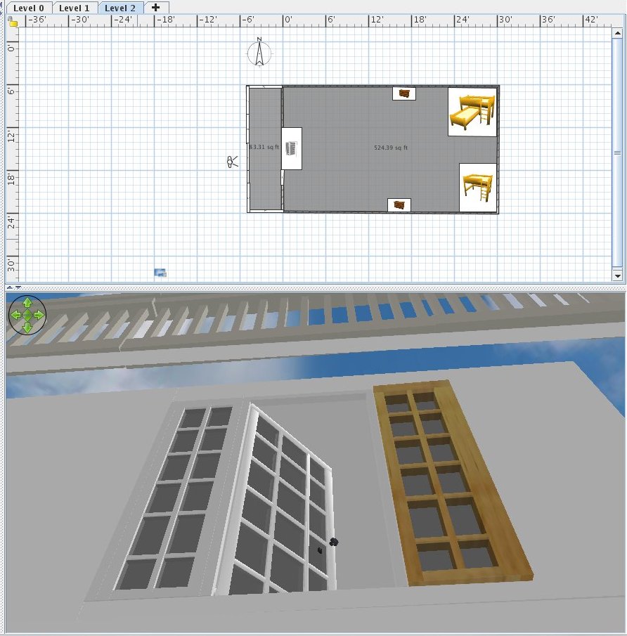

I made a swimming pool in the back yard of a house I'm testing. I also made a "basement" but it's more like a crawl space. You can't see it unless you go down there. :)
I'm attaching snapshots so you can see.
Attachment SH3D-34betafunweb.jpeg (146069 bytes) (Download count: 3606252) (Hopefully, these will show in order: Pic #1: Screenshot of the house with a transparent view so you can see the floors with furniture. 2nd pic: the house rendered with the sunflow renderer. )
Attachment Sweethome-beta34outside-web.png (192914 bytes) (Download count: 3325735) (Hopefully, these will show in order: Pic #1: Screenshot of the house with a transparent view so you can see the floors with furniture. 2nd pic: the house rendered with the sunflow renderer. )
