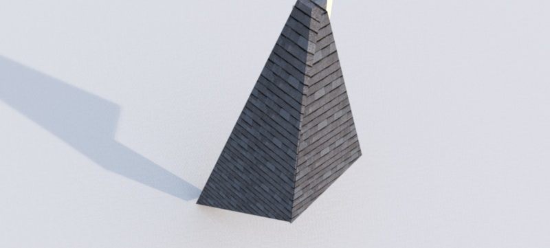

Please refer to the youtube website: http://www.youtube.com/user/MrScleea/videos
It is a traditional Chinese interpretation, I hope help to you.

Re: Pyramidal roof
Ah, of course, you make each side out of two right-angle triangles! Clever!

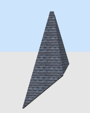

Sure. Here is what I get if I just take a simple pyramidal roof:
As you can see, the pyramid will descend into the room. Therefore I must get rid of everything under the roof, marked in red here:
The problem is the area marked in blue. I'm not able to create anything like that, since all sides are sloping in some way.
It doesn't help if you bisect it in two, because you still have two sides sloping in the resulting section, and walls can only have one side out of four sloping.

OK, I hope to get time to upgrade soon; I'm using 3.1 at the moment. Also interesting idea to use the floor to make a piece.
I did also find a 3D software: "Misfit model 3D" which is actually possible to understand and use for normal humans. It's quite primitive, but I succeeded in importing the pyramidal roof, and cutting away the correct parts. So I'll soon have my roof ready.
