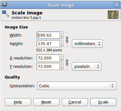

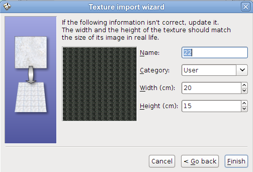

Re: Pictures on the walls ?
Liviu,
In The Gimp use Image --> Scale image... and set to millimeters and 72 dpi. (see picture)
Then enter the size and save the image.
During importing in SH3D you can set the size of the texture according to the measure system you have set in Preferences. (see picture)
