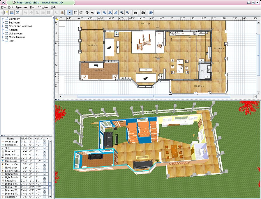

I opened a home that I had made in an older version of SH3D and I saw that the flooring was acting strange. older SH3D home The floor is cut off and looks strange. I've even experimented by copying and pasting the home in a new file but that did not make much of a difference.

I tried to improve the computation of floors in the 3D view in Sweet Home 3D 2.2.
There were lot of cases where it was wrong, but I may have forgotten some cases. [:(]
Please, try to remove everything expect rooms from your SH3D file, and if the bug is still here, send it to [url=mailto:[email protected]]me[/url] to see what's going on.

It looks like the bug you mention happens when the different rooms of a home overlap too often.
I didn't find how to fix it yet. Meanwhile, try to create rooms that touch themselves and don't overlap.
