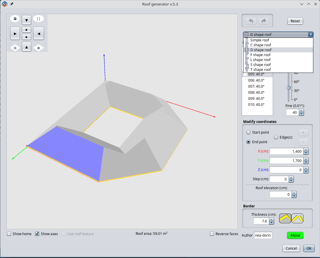

New version 5.3 is also available onSourceForge, as well as through the Plugin Manager.

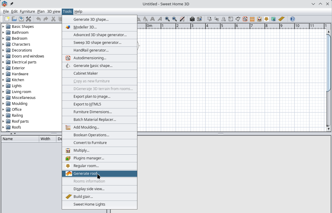

A brief reminder of how it works (especially for newcomers, if there are any):
  • The plugin is located in the menu Tools -> Generate roof...
  • The plugin generates texturable 3D objects that can typically be used as roofs, but not exclusively. It's up to your imagination.
  • Method 1. Draw a room or a large room and other smaller rooms (inner courtyard(s)) that completely overlap the large one (as roof projection),
    select it(them) and start the plugin.
    Modify the roof in the plugin and save it.
  • Method 2. Select, a existing roof made previously with this plugin (version >= 4.5) and modify as you wish.
  • Method 3. Without selecting any rooms or roofs, launch the plugin and use one of the built-in samples.
  • You can insert skylights from the special roof windows furniture library. (Search for and read the user manual)
What's new in this version:
I kept the old bugs and added some new ones
  • -Replace the navigation panel with a new one.
  • -Some small modifications to UI.
  • -The plugin entry is now always available
  • -I've added a few simple examples to use when no room or roof created previously with this plugin is selected.
  • -Remove the feature of cleaning collinear points from the initial rooms.
  • -Replace the local Undo/Redo mechanism with the one inspired from Terrain generator plugin @author Emmanuel Puybaret.
  • -Improve reset mechanism.
  • -fix a bug in fine angle spinner.
  • -Modify the display logic for the selected edge and points.
  • --Points will appear on all selected edges if the corresponding button is selected;
    -- otherwise, only the edges will remain selected, and both of their coordinates can be modified.
  • -update translations files (AI help)
TODO:
---Make round holes for skylights (or irregular shapes).
---Implementation of roof profiles
---Computing the Roof Structure (Frame)
