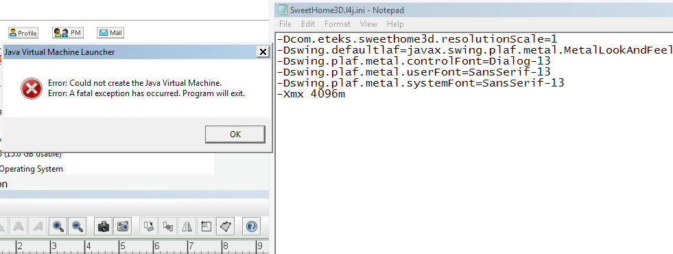

I tried the numbers vincemay used but but sweethome would not start, halved the value, then halved it again, neither allowed sweethome to start
this is my pc

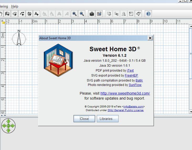

this is my sweethome version
Could you tell me what to add in the ini please.

this is the error i am getting

Mike, remove the space after -Xmx
The memory size should come just after, like in -Xmx2048m

With my set up what is the highest value am i able to use

The usable maximum depends on how much RAM is available in your computer and how much memory is used by the system and other programs. Beyond that limit, there are chances that the computer will have to swap more often, slowing down everything.
If your computer has 16 GB RAM, I think -Xmx8g (8 GB) will let plenty of RAM for Sweet Home 3D.
