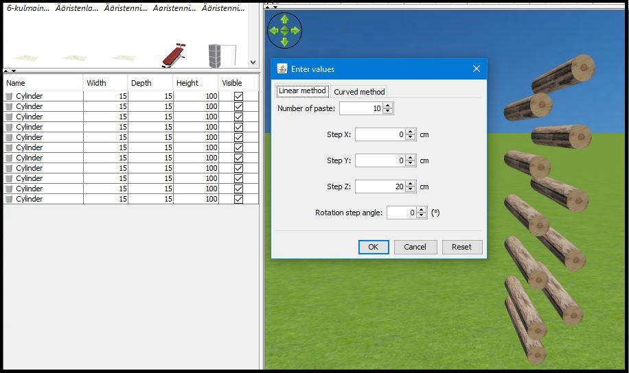

Hi Dorin, I am using plugin version 1.3.
I noticed that when Step X and Step Y are zero, multiple paste uses SH3D:s default offset values (?) for x and y instead of Step X and Step Y after first paste. Any other values than 0 (or 0.0) works as should.
In screen capture each cylinder should be 20 cm higher than previous and straight above it.
I hope the picture explain things better than me..
Thanks for excellent tool, I have a lot of use for it!

1.Errata: I messed up the version numbers in previous post.
Have to be 2.2 in place of 1.3(well, age...)
2. Thanks Seppo!
I've have this problem from the beginning and only now, thanks to You, I think I've found a solution.
So, New version 2.3
-solve (somehow) to trick default offset of SH3D which don't let to paste items on the same place
Also on Source Forge
