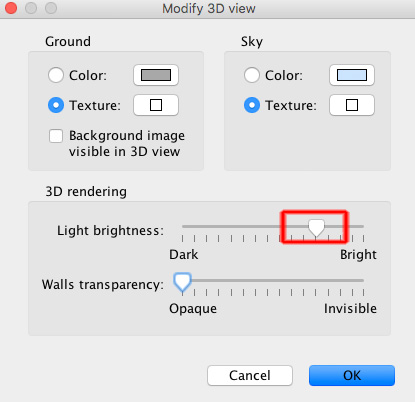

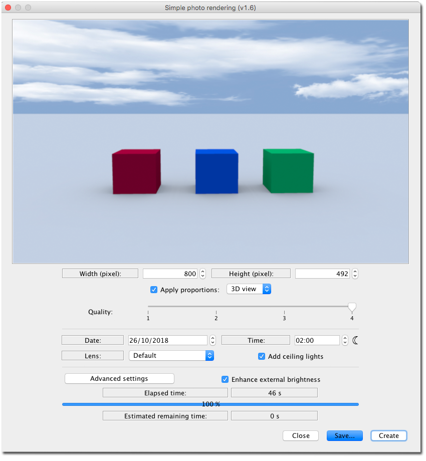

To best manage colours, the first thing you should do is to calibrate the brightness of your 3d view,
if you haven't done that already:
Apply a completely white texture to the sky.
Render different coloured objects with enhance external brightness checked, and no sunlight.
Adjust the brightness of the 3D view until the brightness is as close to the rendered image as possible.
_______
I find that applying a white top to a partly clouded sky image, is a good way to get nice daylight colours when using the enhanced brightness option.

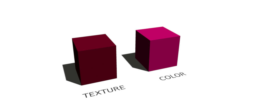

This picture shows what's wrong in my opinion:
- The left cube has a texture which is only colored as #520015
- The right cube has the color #520015 directly
In my opinion both cubes should look the same, we should see exactly the same color. But only the textured cube shows the color #520015 as it should be.

You are absolutely right!
I totally misunderstood the problem.

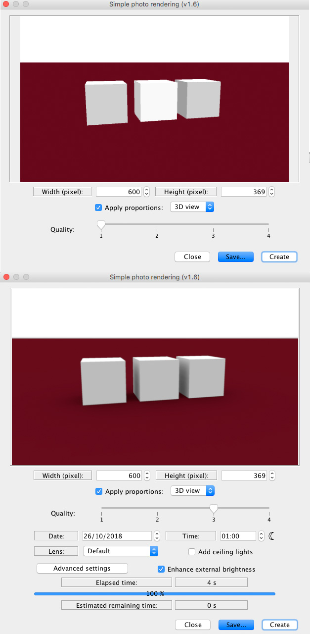

Here is a test with white, showing the opposite effect between the preview and the rendered image.
