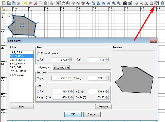

I'm having the same problem - the dimensions are smaller, but the problem is that while the house has right angles the lot dimensions do NOT. When I try to create an area for the lot itself, the horizontal boundaries lines forced to 15 degree increments. I know there has to be some way to place the lot lines more precisely. BTW, I'm just using PolyLines to mark the boundary and have it on the main level - unless there's a better way to do that.

Advanced Editing plug-in
User's guide:
To help you drawing parallel walls, the angle of the walls on the floor is a multiple of 15° by default. You may cancel this magnetism by disabling magnetism in the preferences dialog box or by holding the Alt key pressed during the drawing under Windows, the cmd key under Mac OS X or the Shift + Alt keys under Linux.
