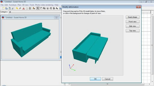

Here's my first test model with new prefixes. Sofa turns into bed, with one part rotating around hinge and the other one moving along rail.
Download obj+mtl: sofa-bed-1.zip
Sketchup file: sofa-bed.skp

Very nice. It will be interesting to test different ways of using the prefixes. ok

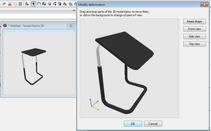

I have a few ideas but I don't have tool (or skills) to make really nice models. I can explore and show some solutions, explain how it works - it gives me more fun than just creating perfect piece of art.
Laptop table - you can adjust height and tilt.

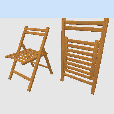

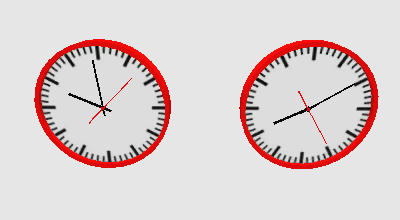

laptop_table.zip
clock.zip
chair.zip

Clock is already available on sourceforge.net (#503 )
Guys, I need your opinion about few things. Here (#504 ) is sh3d file with some models - look at it and let me know what looks better or what is total failure.

I really like your creations! In my opinion, the brown wooden chair and the four legged round chair look better than the others.
I'm not sure where the difference is with the scissors, but I think the reflections on the left one look better for me ...
