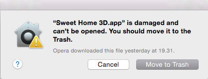

I have a slight problem:
Normally SH3D is running perfectly after increasing the memory in the info.plist file, but today, after downloading and installing and it on a Mac Pro, it will not run.
The problem is that I'm far from home ( I'm in Germany), and I'm actually here to work on a project that requires a better machine than my laptop. As agreed, they have given me an office with a 3 year old Mac Pro, equal to the one I use at home.
The program runs perfect until I edit the info.plist-file, but with only 1GB max, it won't even load my project.
I have edited the info-plist-file dozens of times before, and had no problems. I have even compared it to the one on my laptop, and it's totally identical, so I'm obviously not doing anything wrong.
Any suggestions? Anyone had the same trouble?

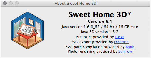

I don't think this error can happen with the free version. If you use the Mac App Store version on this other computer (see About dialog box), please update to version 5.4.2 and read the FAQ How can I adjust the memory used by Sweet Home 3D?. I updated it recently when I found a solution to increase memory with Mac App Store version.

Yes, it's the free version we're using, downloaded yesterday evening from Sourceforge.
We tried it again to day on another Mac, and the same thing happened.
But we HAVE found a way around it:
A question arose during lunch: Have you tried copying the program off your Macbook, and run it on the Mac Pro?
So we did, and it worked. The obvious solution.
I have uploaded the damaged app in case you want to have a look at it.
Sweet Home 3D app damaged
