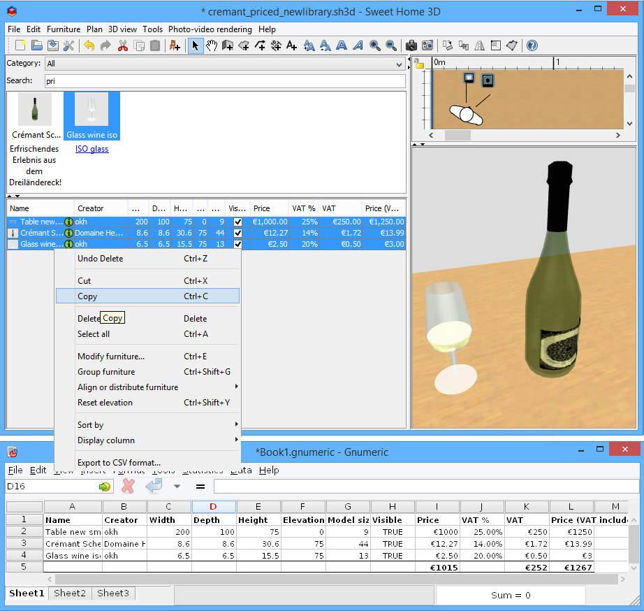

Actually, no. Thanks again, it was almost too easy to make it work. And just copy/paste items to spreadsheet had no hiccups. Interesting, also like the VAT calculation. Had to smile when I noticed that it was Feature request no 7. While I think this is a potentially useful feature, I also realise that there may be some considerations in terms of how to implement as default. But now I know it is already there - and will use it. Thanks. ok

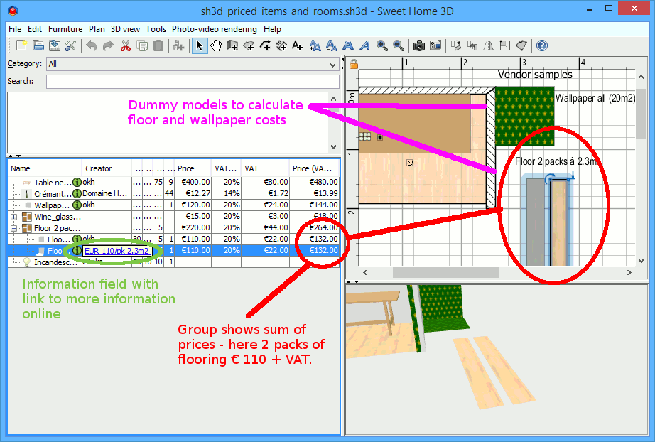

And groups are presented with sums of all prices. Impressive! This already works beyond expectations.
My vote would probably be letting user enter prices directly from SH3D and not rely on FurnitureLibraryEditor. IF you were to implement, that is. I appreciate the comments you have made on this before, but maybe a separate implementation through a plug-in that could:
de-comment/set a default currency in DefaultUserPreferences.properties
Add model information:
information='' (maybe even linkable ->8330?)
price=' '
valueAddedTaxPercentage=''
currency='EUR'
Clearly some caveats would be in order, but now that I have tried, it really gets quite tempting... It is almost a shame not to make use of this feature that is already implemented, and my guess is that an interface would be popular. Here with dummy models for wall paper and floorboards to include in the calculation.

For an urgent need, without going through the not-intended-for-end-user steps above, I suspect your simplest way of getting a price-list, is to select the furniture you need prices for in the furniture list, copy and paste to a spreadsheet (pay attention to locale/currency settings). And add prices to your items in the spreadsheet.
Even with the latter method, there are a couple of cheats/workarounds. You could add the price in the name field with a special delimiter for the spreadsheet import (e.g. ¤) - or import the furniture putting the price in the creator field. Neither of which are very elegant, but well, if it is urgent...
