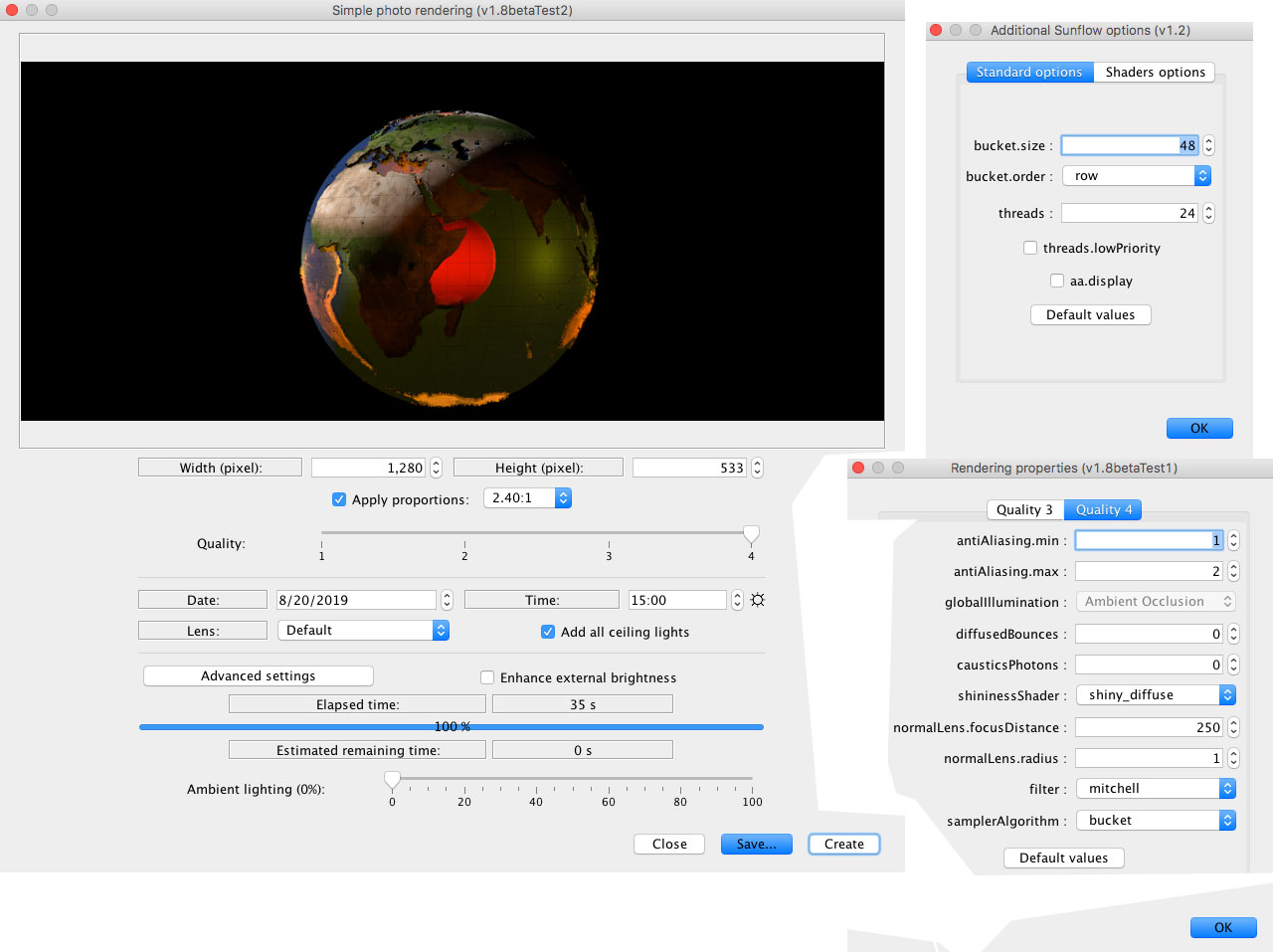

Perfect!
After some testing, I have found that a buffer size of 48 is marginally faster than 64 and 32.
Is it automatically detecting the number of threads available?
Quite oddly, it seems that choosing different bucket orders has an impact on the rendering time.
This is rendered with column.
Hilbert : 39 s
Spiral : 39 s
Row : 38 s
Column : 35 s
Diagonal : 35 s
Random: 48 s
I didn't try the reverse options – but I must admit I was somewhat curious about the reverse random...
I noticed no difference with the threads.lowPriority activated.

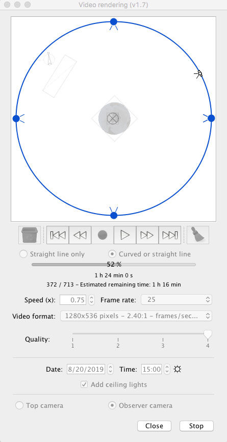

The project file is meant as an illustration of the rather hot inner core of the earth (intended for the education of my daughters),
and I wanted it to spin, so I tried making a video.
It seems the video will not render in Q4, but stops about half way.
I'm including the project file, in case anyone wants to give it a try ( 1280 x 536 )

@Ceciliabr
Yes, the number of threads by default is the number of available processors (CPU) that will be the maximum value because I noticed a bug by opening your file on my computer which has only 4 cores.
I think it depends on the scene.
With yours where the subject is central and the background black, the order has an influence especially on the calculation of the remaining time.
The "reverse random" bucket order will be removed.
This is what I also found but I do not do any action in the plan or the 3D view during a rendering.
Version 1.7 of the plug-in uses only the default values of the new options.
I will test with different video format because the lighting significantly increases the duration of the rendering.

@Ceciliabr
I have tested, and tested, and tested again, and again, and I have found nothing wrong.
Regarding the problem of video rendering, everything works correctly?
On my side it's random for a new simple project: a single object and a linear or circular camera path.
