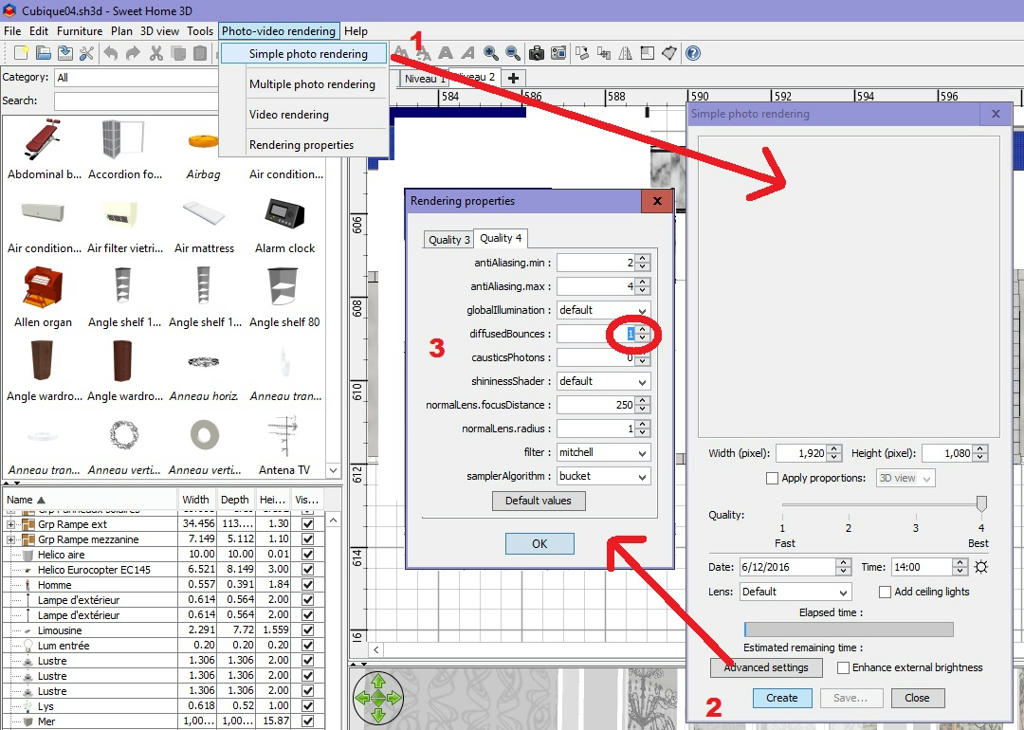

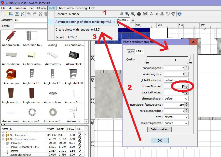

It's a good idea smile but it's not finished because I saw 2 problems. sad
A. I downloaded the previous Tools R1.3.2 with parameters 1.3.1 in Tools menu.
=> Yesterday, I downloaded the new menu 'Photo-video rendering' and the old menu was always present. crying
Why and how can we delete the old ?
B. Problem in parameters
When I use your new menu 'advanced settings', I cannot change value of DiffusedBounces (1 => 2) !!!
=> With the old menu it is possible. tongue
Is it a regression or just an oblivion ?
=> Can you evolve it ?
I think that with this kind of update, you must have a global vision and don't go too fast and I know that it's not easy... d oh

Re: Photo-video rendering plug-in
You must manually remove the plug-ins from the Tools menu if you no longer want to use them.
Help -> About... -> Librairies...
- click on a file in Plug-ins
- close SH3D
- delete the plug-ins
These old plug-ins do not benefit from the improvements and corrections made to SH3D-5.3.
The new plug-in is included in a compressed folder to be replaced more easily in future updates.
As stated here , safeguards have been put in place to avoid any confusion in the interactions between parameters.
