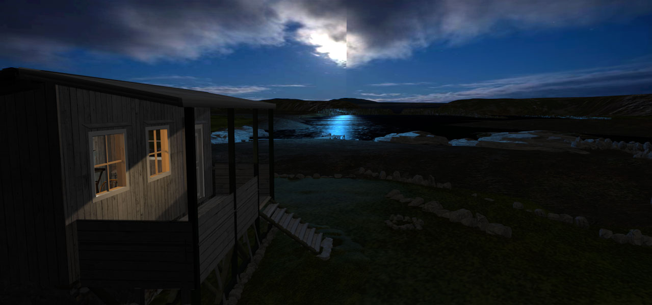

I just have to ask: Is it possible to rotate the sky?
Not only to avoid this:
but also to be able to move the sky and find the best part of it.
On stills, this is easy to edit, but if you are making a video, it get's a bit more complicated.

This problem, however, is not solved by using the mirror image technique, since the main object (the moon) must be placed exactly where the sky is joined, and mirroring it only creates a kaleidoscope-effect (like on your veryCloudy.jpg sky, where you can see the face of a geriatric hippie at the joint, with a little imagination if you look closely -:)).

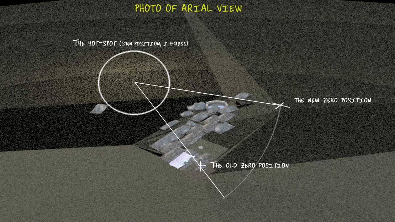

I rotated the whole scene 90ᴼ. Afterwards I placed a 100 X 100 meter (biggest possible, to show the dimensions of the construction) white cross at the new zero point. As you can see, the scene's zero point was shifted from 0, 0 to -6,500, 130 (which makes it quite a job to re-calculate my long list of stored positions).
Now, how does the rotate-function determine the center point, and why should it disregard the original zero point of the matrix, as long as the entire layout is selected? Would it not be both the simplest and the most natural to define the pivot at 0, 0 ?

The problem occurs when the splice happens in the middle of an important object, as showed in the image. To have a continuing image across the splice, seems to be extremely hard to accomplish. An option to rotate the hemisphere, would make it easier.
