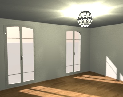

Double light source with default renderer setting

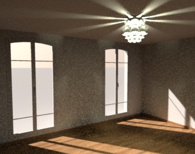

One light source with path value for globalIllumination and 1 as diffusedBounces
