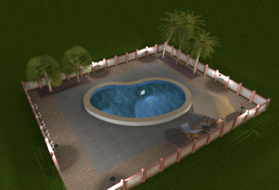

Hi choppyleo, the blog post on how to design a swimming pool, with an example .sh3d file, is a good demonstration on how to use light-sources too.
How to design a swimming pool
