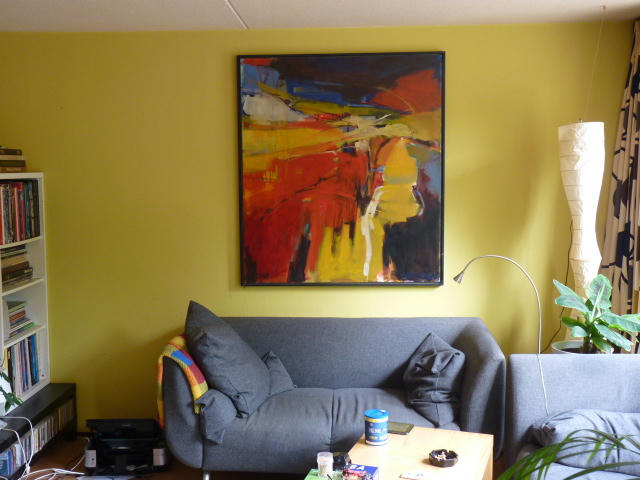

Marko,
Below you can see a picture of part of my living room.
As you may notice the yellow wall has many different colours, even though the wall is painted in just ONE colour.
So, if SH3D shows many different colours, it correctly mimics what you see in real life.
H

Thanks guys for your reply.
I do understand there are shadings in real life with possibly quite a big difference in one area depending on lights.
Bottom line is, these colors look so much too green to us. Maybe it is our monitors or eyes, or we're just crazy I don't know smile
@hal9000, on what you wrote - the last image was with full brightness set. This does bring us closer to what we want to see, but makes white under any light impossible to see (in example, you can notice a lamp and white on the right side of the image and what it does to white areas). We are exploring walls (and kitchen elements) with white + yellow combination, and it has been a struggle to get this look anything (what we would consider) realistic.
Again, thanks for support, really trying to understand is it us, or there is something what we can do.
