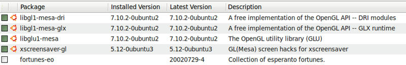

John,
I'm using Ubuntu 11.04 - 64 bits.
After reading your message, I decided to check which GLX version I have installed.
It seems that I have a different version installed than the one you suggest.
Nevertheless, SH3D runs without any problem on my computer.
