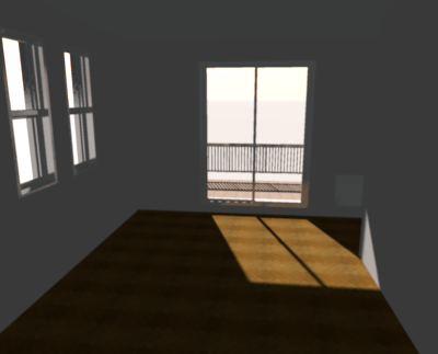

When I render my room layouts, I would like to see how they look during the day, with no lights turned on. Unfortunately I always end up with sunlight streaming through the windows, and the rest of the room almost black. Is there any way of increasing the dynamic range to reproduce the room more as our eyes would see it, or providing a multiple exposure feature to allow for HDR software to process the results.

Even if this sounds as a good idea, I don't think it could work even if you add more light sources outside. It's because light reflections are limited in Sweet Home 3D, otherwise it would take too long to compute an image. I know computed images are therefore less realistic, but it's a tradeoff.
Sometimes, I'm tempted to add an additional higher quality level that would use the capabilities offered by SunFlow Instant GI, but I believe users prefer to add more lights and get faster a nicer image.
For example, the following image of an empty room was rendered in 3h50 (13800 seconds!) with Instant GI on an i7 processor (measured from the value displayed in a top command) :
With the current renderer that uses some ambient occlusion and no additional light the same image was rendered in 31 seconds:
With one large light added at the ceiling of the room, the image is computed in 42 seconds and looks much nicer at the end:
