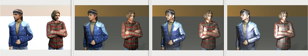

Gentlemen (and gentleladies, off course):
Here is a short test with four shaders, from left to right: Photo, Advanced photo, Phong and Uber.
The two gentlemen are from Google, there is one strong light approx. 50-75 cms in front of them at 1.50 meters height.
I'll do some more tests tomorrow; there's a political debate on TV that begs my attention.
