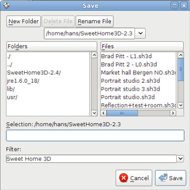

Bandit:
If you save a model you will see in the save-window ./ and .//
Double-click ../ and you will move to a "higher" directory. The address bar will show you where you are.
When you are at the top directory, you can go "down" again and follow the path where you reach the "user" directory where all your other files are saved as well.

Sorry Hansmex I am totally lost with your last responce on what to do in the save window. I have never seen that window in this program. And like I've said before, I was able to save up until now and I have been working on this project for almost a month so I have done alot of saving. Could you please give me direction of how to get to that window?

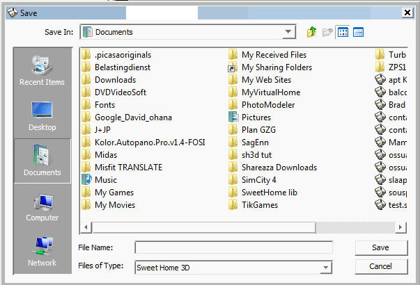

Bandit:
That was the Ubuntu save window. If you use Windows it looks like the picture below, just go to File --> Save and the Windows save window opens.
To the right of the word Documents you see a little icon with a green arrow that points upwards. Click that icon until you are at C:\. Then go down into your directories until you reach C:\Documents and Settings\User\MyDocuments\Home2.sh3d. Or maybe it's called C:\Documents and Settings\User\user\MyDocuments\Home2.sh3d, but it should not have the word "administrator" in the address line.
I hope this helps.
