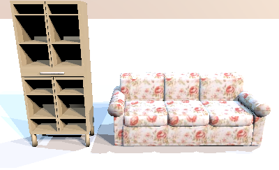

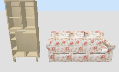

3D image looks funny,but convert to high quality pics format look normal Why?
Hi, I had just installed the latest sweet home 3D 2.5 versions. But everything looks good, until when I try to put in some furniture products that I had created before, then I notice that, some of the image looks funny. Then when I convert them into high quality pictures image, then look back to normal. I would like to ask, do anymore encounter this problem before? I hope there some one here is willing to share to help me to solve this problem. Your kind help will be very much appreciated. Thanks.
[IMG]http://i252.photobucket.com/albums/hh10/lowpricedelivery/picturewithproblem.png[/IMG]
http://i252.photobucket.com/albums/hh10/lowpr...picturewithoutproblem.png

LPD:
Similar problems have been reported before. The probable cause is an "extremely" large texture (or textures) with sizes bigger than 2000x2000 pixels.
A solution could be to reduce the resolution of your texture(s), although the resulting photo render may be disappointing in case of the flowered couch.
