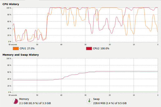

Today I downloaded some plant models from the Google repository. All in DAE-format and for the amount of detail shown, they're rather small files. Unfortunately SH3D locks after inserting the model into a design. Using the system monitor I noticed that the processor starts running at around 100% (see screen shot) and memory usage increase from a "moderate" 400 Mb after a clean start-up, to 1.1 Gb a few moments after inserting the dae-model into a design (that consists of only this 33.2 Kb dae-model).

I have exactly the same CPU usage (while navigating, drops to around 15% while no navigation) and memory usage (around 1.25 GB) while the model is imported. Except no crashes under Windows 7.
