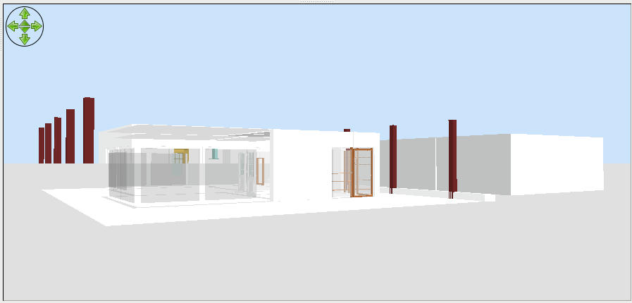

I first opened your file in SH3D v2.3 while having already another instance of SH3D open. The file opened without any problem, but there was a small quirk in the 3D display.
I then closed both instances of SH3D and opened the file in SH3D v2.4 b5. It opened but the 3D display was rather mixed up, as shown below.
I then closed the beta and re-opened the file in SH3D v2.3, this time the file crashed op opening.

Below is how it is looking on my machine with version 2.3. I am also wondering if the graphics corruption you found with version 2.4, windows appearing in front of your plant, could also be a graphics card issue? I can try your file on my machine if it helps?
I did manage to crash version 2.4 beta 5 with this file but that was running under visualization, the display started to corrupt and not long after it crashed.
