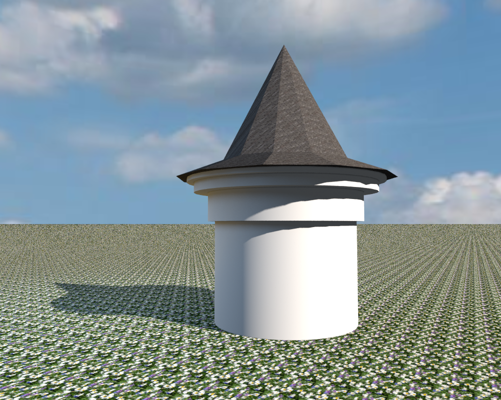

some complex roofs, such as your conical roof on a round tower, can be made using figures from the website of the respected Keet (Dodecagon). There are cones with 12 faces. Unfortunately, the Keet shapes do not allow you to apply textures correctly, they begin to lie at an angle and slide down. But you can ignore it. Or use color instead of tile texture. For example, the roof of a tower made of two Dodecagon cones with 12 faces, it is important to accurately combine these cones, the alignment tools in SH3D will help (they are in the "Furniture" column, you first need to make all shapes of the same width and depth, align, and then return them to the desired dimensions, then they will center relative to each other). I will now try to make your other straight roofs in simple ways.
Now we can't have that! I added 6 texturable cones to the DodecagonShapes library, 2 smooth (different texture mapping), 2 12-sided (different texture mapping), and a 6 and 8 sided cone.
Have fun!

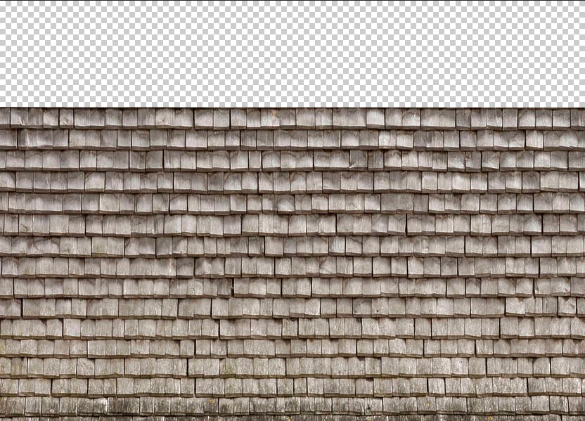

Thanks Keet! So far, I have found one face of the pyramid on which the texture fits correctly. I made the other faces invisible and combined them into a group. To get the long side of the roof, I applied several edges with a slight offset. And most importantly, for the texture, I used a PNG texture of a tiled roof, from which I cut out the upper part. I did this in Photoshop. Therefore, the result is not a pyramid with a vertex, but a cut-off vertex. It's on the roof of our esteemed Indigo Solo.
There's a hole on top, of course, if you take a picture from above, you need to insert the lid from the box.
