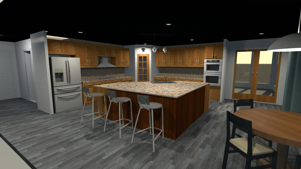

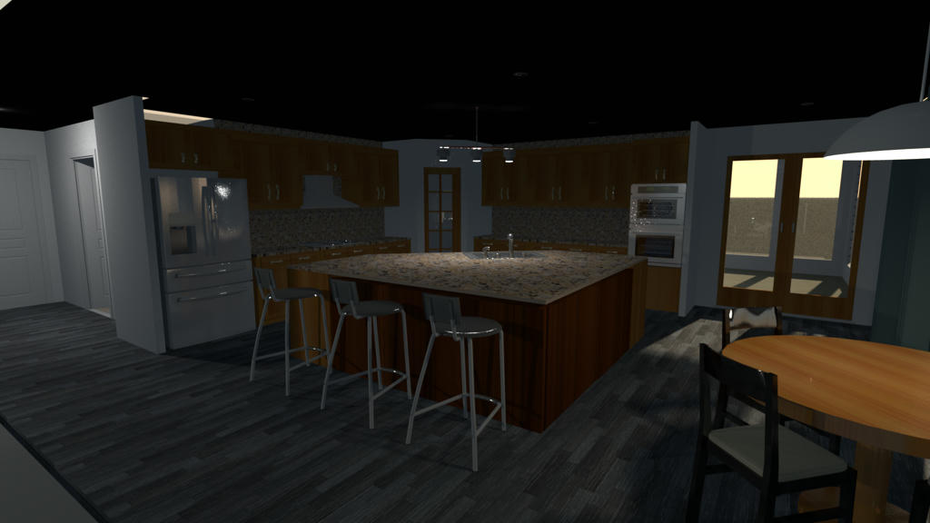

First off, hats off to the developers... SH3D is an excellent program. It's so robust, yet simple to use. I've only been with it for a couple weeks now but love all the features. I have run into a couple of problems though when creating photos (refer to images below).
Image 1 was generated using Yafaray, Image 2 with the default engine. Both use the same basic settings (Size, Quality, Date/Time, Lens) but obviously VERY different results. Been trying to use 'recessed lights' but with mixed results.
Questions:
  • Why is one image so much darker than the other?
  • Why are my 'recessed lights' missing in Image 2?
  • How do I eliminate the 'sparkle' effect on the refrigerator, chairs and oven?
  • Is the 'speckling' near the top of the walls a common anomaly?
  • Any tips/suggestions for improving my lighting?
Thanks in advance!

Re: What's Wrong With These Photos?
Welcome on the forum.
Because the recessed lights are not visible in the second image, probably meaning they don't diffuse any light.
Maybe they are a little too high?
Make them mat.
I think you mean "noise" (yes, like in photography at high ISO). To get less noise, render a larger image then downsize it with any image tool, or use Advanced Settings Photo Rendering plug-in to increase anti aliasing parameters (see also here).
As lights doesn't bounce your ceiling looks too dark, you could add some large lights to fix that as suggested in this tip.
