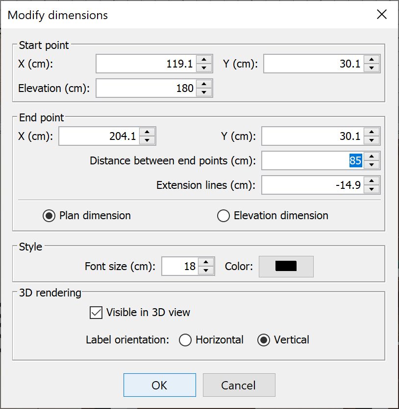

Editing dimensions and elevation dimensions
The new Plan > Modify dimensions menu item or a double click on a dimension now displays the following modification dialog box to let you enter directly its coordinates or its length.
Editing dimensions and elevation dimensions. Editing dimensions and elevation dimensions
When you modify two or more dimensions with this pane, the Distance between end points field won’t be shown because it’s often too complicated to handle such modifications.
This pane lets you change the coordinates, the font size and the color of the dimensions, as well as choose if dimensions should be visible in the 3D view. When a dimension is visible in the 3D view, it’s possible to change its elevation and the text of its length is always written in the correct direction whatever the current point of view.

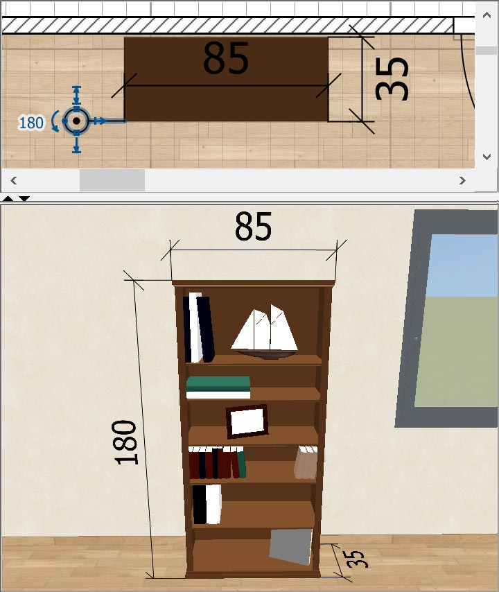

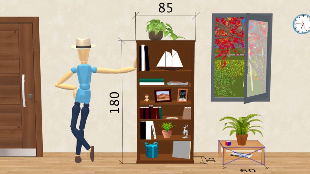

This pane proposes also to choose whether a dimension should be a Plan dimension or an Elevation dimension, i.e. a dimension used to indicate the height of an item as shown in the following image for the dimension 180. This image shows also the two different label orientations you may use for plan dimensions visible in 3D view, the dimension 35 being a plan dimension with a horizontal length label, and the dimension 85 a plan dimension elevated at 180 cm and with a vertical length label.
3 different kinds of dimensions in 3D view

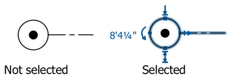

An elevation dimension is displayed in the plan with a symbol showing two circles (something like an arrow seen from top) and an extension line.
When selected, an elevation dimension shows the height and 4 indicators to set the elevation of its start point, its height, the offset of the extension lines and its angle around elevation axis. You may create elevation dimensions directly with Dimensions creation tool if you press the Ctrl key (alt / option key under macOS) while clicking at the first point of the dimension in the plan. In that case, the Dimension pane will be shown after the click with Elevation dimension and Visible in 3D view selected options and a default distance between end points equal to home wall height. Just adjust the values and confirm your choice to create the elevation dimension accordingly.

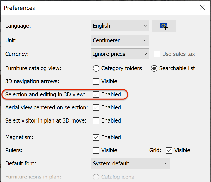

Editing in the 3D view
A new Selection and editing in 3D view option was added in the preferences pane.
When this option is enabled, it’s possible to:
  • Select objets in the 3D view with a simple click (or Shift + click to toggle its selection). Selected objects are surrounded with a half transparent blue line and the front face of selected furniture shows crossed lines.
  • Modify an object by double clicking on it.
  • Use the items of Edit menu when the 3D view has focus.
  • Move selected furniture in the 3D view with a drag and drop, where magnetism (toggled with Alt key / command key under macOS), alignment along X / Y axes (Shift key after you press the mouse button), duplication (Ctrl key / option key under macOS after you press the mouse button mouse) works like in the plan. Moved furniture remain at the same elevation, and their x / y coordinates are updated according to the current view angle, with vertical mouse moves converted to moves along the depth. Only furniture can move and furniture part of the base plan as well as other types of items can’t be selected when the base plan is locked.
  • Elevate the selected piece of furniture or furniture group by pressing the Ctrl key (option key under macOS) before you press the mouse button and move the mouse.
  • Rotate the selected piece or group by pressing the Shift + Ctrl keys (shift + option keys under macOS) before you press the mouse button and move it.
  • Drag and drop an item of the catalog in the 3D view to add it to your home. Objects dropped on a wall appear along that wall or in the wall if it’s a door or a window. An object dropped on an other piece will be elevated at the elevation defined by its dropOnTopElevation property, and an object dropped on a shelf unit will appear at the elevation of the shelf where the object was dropped.

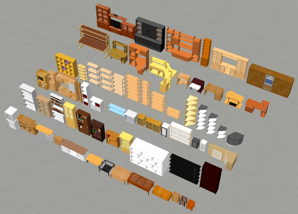

To help you decorate your shelves faster, these properties were defined on the shelf units and other furniture with shelves available in the updated version 1.9.1 of Furniture Libraries.
Magnetism on shelf units
Furniture with shelves among free models

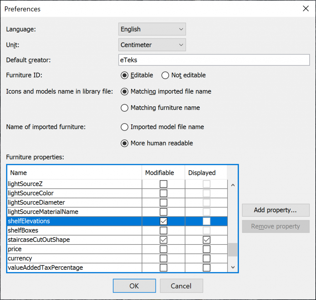

If you want to define these properties for your own furniture models, see this thread in the forum or try the version 2.0 of the Furniture Library Editor which lets to define them more easily, once you enabled these properties in the new section Furniture properties of its preferences pane.
Sweet Home 3D 7.2. Preferences pane of Furniture Library Editor 2.0

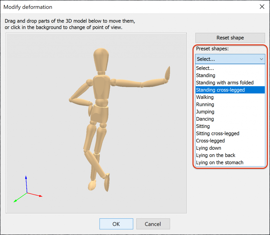

Since version 6.0, it has been possible to modify openings and postures of objects configured to support deformations. But if opening a window isn’t very difficult, it’s more tedious to find a good posture for mannequins, the reason why some preset postures have been defined for the 6 mannequins available in default catalog and in the updated Scopia library. So if you look for a sit posture or a laid down one, you can now choose a preset posture to start from in the Modify deformation dialog box, then customize it for your needs (see also this tutorial if needed).
Mannequins preset postures

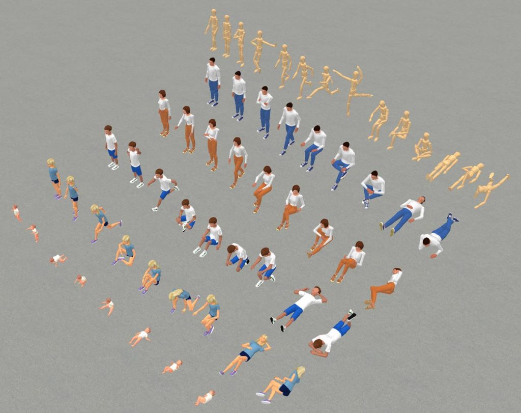

With the default postures, you now have 58 preset postures to help you. And thanks to the nice contributors of Sweet Home 3D, they are all translated!
Sweet Home 3D 7.2. The 58 preset postures of Sweet Home 3D mannequins
