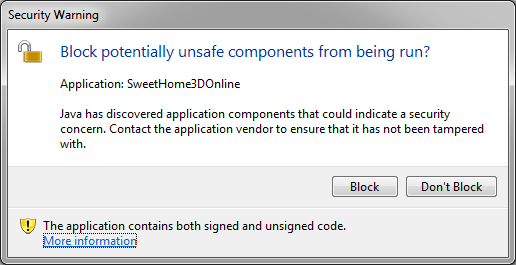

From the latest update of Java, Oracle decided that calling some methods of a Java applet from JavaScript could lead to some security issues. That’s the reason why you may have seen the following new freaking dialog box when running Sweet Home 3D Online recently.
Sweet Home 3D 4.1. security warning
In Sweet Home 3D case, choosing Block prevented the browser from checking if you saved your work before leaving the web page. Anyway, I fixed this issue following Oracle instructions and this dialog box won’t appear anymore.
