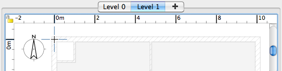

Sweet Home 3D is now able to manage multiple levels, either above the ground, or underground. To create a new level, choose the Plan > Add level menu item. As soon as the home contains more than one level, tabs with their name are displayed at the top of the home plan to let you select the level where items will be drawn. To help you draw the rooms of the upper floor, the walls and ceilings of the lower floor are drawn with a light color and magnetism was greatly improved.
add level

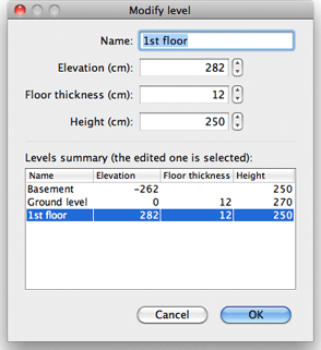

If you want to change the default name or dimensions of a level, you can double click on its tab to edit its attributes with the new level dialog box. This pane presents also the list of existing levels to help you compare home levels to each other.
Sweet Home 3D 3.4. modify level

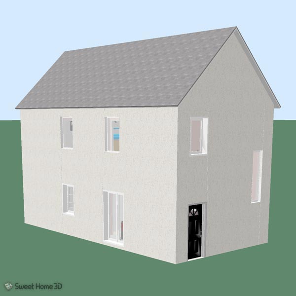

A new house example showing these new capabilities was added to the gallery.
house

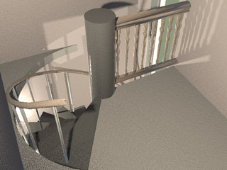

and as the cut out shape of this staircase is round, you’ll get automatically a round cut out in the 1st floor.
Sweet Home 3D 3.4. staircase hole

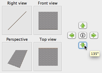

You can now fine tune the orientation of a model in the second step of the Furniture import wizard, if you keep pressed the shift key when you click on the orientation buttons. The I button in the middle resets the orientation.
fine orientation

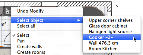

It’s now easier to select an object displayed under other objects in the plan: just right click in the plan at the location of this object and choose it in the Select object contextual menu that appears.
select object
