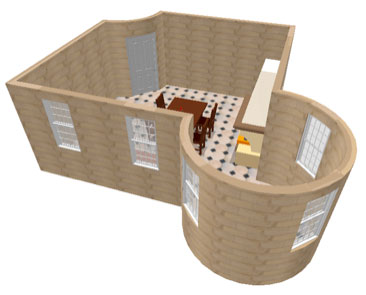

If you keep pressed the ctrl key (or alt key under Mac OS X) while clicking at the end point of a wall, a round wall will be created and its extent angle will depend on the point where you’ll click a third time. You may also change the arc extent of a round wall afterwards with the new Arc extent field in the Wall modification pane.
wall arc extent
As the following image shows, it’s possible to place windows or doors in the round walls but you’ll have to change manually the angle and the depth of the window to build a correct hole in the wall.
Sweet Home 3D 3.0. round walls
I suggest you to use first an invisible box to make a hole in the round wall then place the window in that hole.

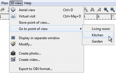

Do you like a particular point of view but still want to navigate in your home? Do you want to compare the view from two different places? You can now store 10 points of view with the new 3D view > Store point of view… menu item and then go back to one of them with the 3D view > Go to point of view menu that will be filled automatically.
storing point of view

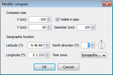

When selected, this compass rose can be moved, resized or rotated as you wish. If you want to hide or show it (homes created with previous versions of Sweet Home 3D won’t show it), use the Visible in plan check box of the Compass modification pane displayed with a double-click on the compass rose or with the new Plan > Modify compass… menu item.
modify compass
This new pane lets you edit compass rose attributes and also the geographic location and the time zone of the place where is the edited house. As there’s no GPS in your computer (or if there’s one, I didn’t learn how to get its information by program yet), you’ll have to check this information if you want to take profit of Sweet Home 3D ability to compute the sun location in the sky.

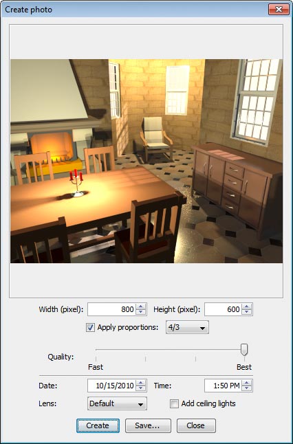

The features proposed by the Advanced rendering plug-in are now completely integrated to Sweet Home 3D itself. All the parameters in relation with home location were added to the Compass pane, and the ones that may vary more often from a photo to an other like Time / Date and Lens were added to the Photo and Video creation dialog when either two best quality settings are selected.
Sweet Home 3D 3.0. creating photo
Lights computed at the middle of each ceiling are still the default lighting model, but you can turn them off and manage yourself where lights should be placed. Depending on the hour of the day and the geographic location of your home, sun rays will also illuminate the rooms of your home.

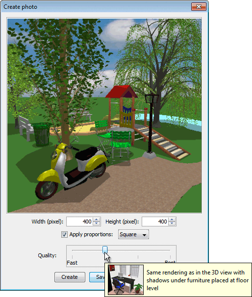

And by the way, the computing of shadows on the floor of 3D models containing many vertices was fixed in the default rendering engine and the second quality photo rendering level works now correctly when you include trees in your layout.
Sweet Home 3D 3.0. shadows quality
