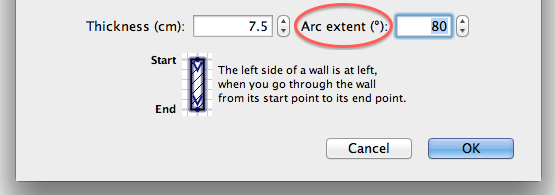

Now you have to draw the walls in the underground level. You may draw a simple rectangular shape for a basic pool, but you can also draw a round shape, using round walls. To do that, draw a quadrilateral shape with points that will placed at key points of the pool, then modify the arc extent of each wall to get the round shape of the pool. To get a bean shape, you’ll probably have to make more than one modification, but after a while you should success. Keep in mind to disable magnetism while you move the end points of the round walls, otherwise the magnetism behavior might prevent you from placing the point where you want.

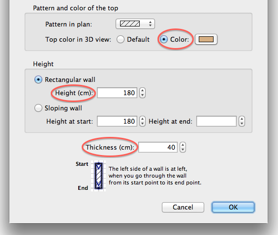

Once done, select all the walls and choose the menu item Plan > Modify walls. Change the height of the walls with a value equal to the depth of the pool plus the height of its edge. Change their thickness with a value equal to the width of the pool edge. Finally, set also the color of the wall top in the 3D view to match the color of the top of the edge.

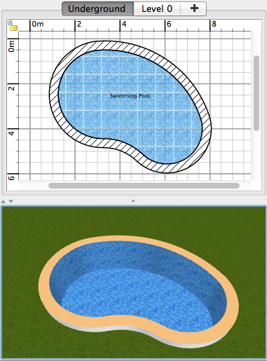

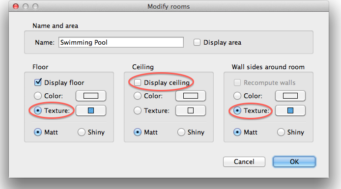

Finally, select the room creation tool and add a room by double-clicking in the center of your pool. Modify this new room to change the color or texture of the bottom of the pool and its wall sides (the texture used here comes from this SH3T library). Unselect also the Display ceiling check box.
Swimming Pool Design. modify rooms

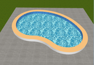

Once the Modify rooms dialog is closed, here is what you should get:
Swimming Pool Design. swimming pool

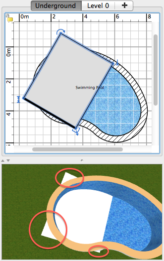

You may add a slope, or skip this step if you don’t want to. First, download the 3D model of a triangle here and import it in the plan: select the Furniture > Import furniture menu item, choose the downloaded file and finish the importation. Place the triangle in the pool and change its width and its height to get a shape matching the slope you want.

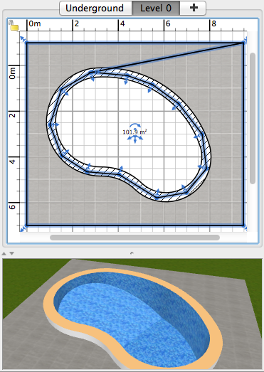

If you’ve drawn a round pool, the triangle will probably go beyond the pool edge and make undesired holes outside the pool, as shown in the following screen capture. To hide these holes, draw a room at the ground level around the pool. As the screen capture shows, this room shouldn’t intersect with the pool surface, otherwise it will hide the bottom of the pool. To achieve this kind of drawing, draw two rooms one beside the other or if you choose the option to draw only one room, draw the points on the pool edge in the reverse order of the points outside the pool.
room around pool
Once the slope triangle is placed
Swimming Pool Design. modified pool
Once the room is drawn around the pool

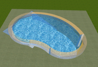

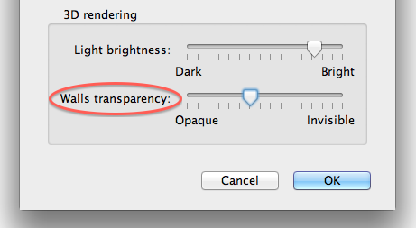

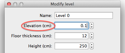

As the screen captures below shows, the water looks correct in the pool but isn’t transparent. If you want it to be transparent, click on the 3D view > Change 3D view menu item and change the walls transparency. The transparency you set will be applied to room floors only if their elevation is greater than 0. As the room you created is at elevation 0, it will be transparent only if you elevate the ground level a little. Thus, temporarily change the ground elevation, by double-clicking on its tab above the plan and set the elevation to 0.1.
walls transparency
modify level
Before changing transparency
Swimming Pool Design after changing transparency
After changing transparency
After these changes, everything is transparent, not only the water. To have only the water transparent as wanted, you’ll have to export the room as a 3D model, and import it again following these steps: select the room matching the water, choose the 3D view > Export to OBJ format menu item, select a name for the 3D model exported file (any name will fit since it’s for temporary use), and, when prompted, click on Export selection button.

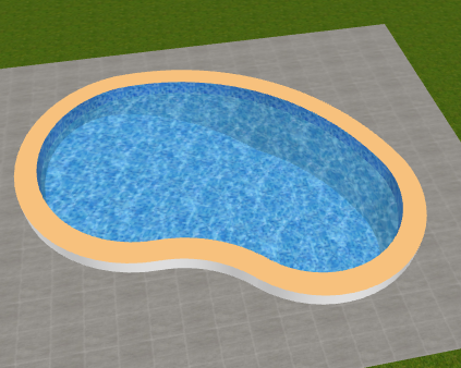

Here is the result you should get:
swimming pool transparent water
Swimming Pool Design. Final result

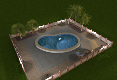

After adding some decorations and a few lights, here is what you can get with the photo creation tool.
Swimming Pool Design swimming pool final result
