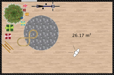

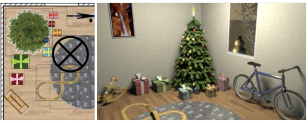

Here is a room with a decorated corner that we want to enlighten (available in the file ChristmasLights.sh3d):
Softer Shadows. christmas room

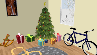

When rendered with the photo creation tool at the fastest quality level and at the best quality level with default ceiling lights, you get the following results:
Softer Shadows. christmas fastest
At the fastest quality level

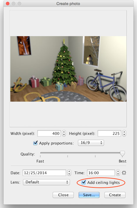

Now, let’s cancel the ceiling light by unselecting the Add ceiling lights check box, add a light source in the room and change its size to see the effect it will give on the shadows in the scene.

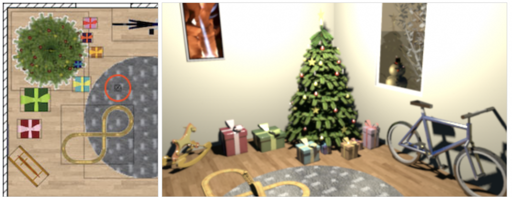

Here is the result with a 50 cm wide light source:

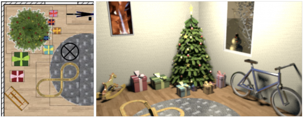

attempt 2

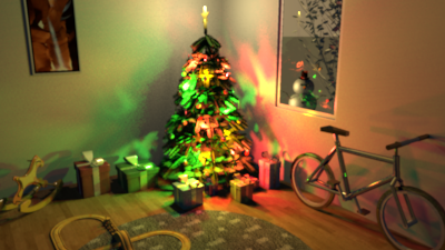

Multiplying light sources might also give softer shadows, but keep in mind that the more lights you’ll add to your plan, the longer it will take to be rendered. You may also try special effects like in the following image where light sources of different colors were placed on the Christmas tree.
multicolor lights
