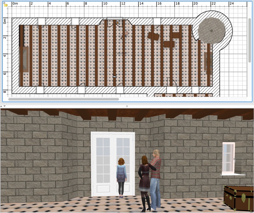

In Sweet Home 3D, all the doors and windows make a hole on the walls in 3D upon which you place them (by the way, did you notice that there are many new ones in the furniture catalogue 1.6?).

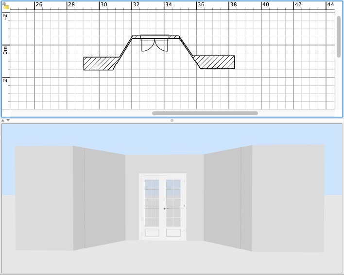

But in the real life, doors and windows in very thick walls are often placed in recesses. In Sweet Home 3D, when you place doors/windows on such walls, the result in the 3D view might look more or less correct when magnetism is enabled, generally showing no recess like the door in the following example.
doors and windows

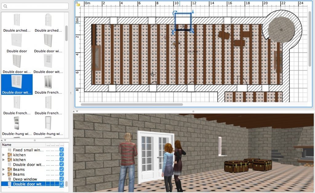

From version 5.5, when magnetism is disabled, you can place doors and windows upon thick walls without Sweet Home 3D setting their depth though. According to their depth and the place where you drop a them on walls, you’ll get recesses with right angles. This tip shows two ways to design beveled recesses to make them look more realistic.

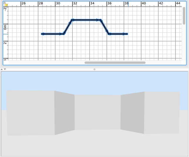

SelectPlan > Create wallsmenu item, and in an empty part of your plan (or in a new document), draw five thin wall parts like in the following screen capture.
draw five wall portions

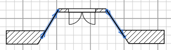

Set the smallest thickness (0.1 cm) of the two remaining wall parts.
set minimal thickness

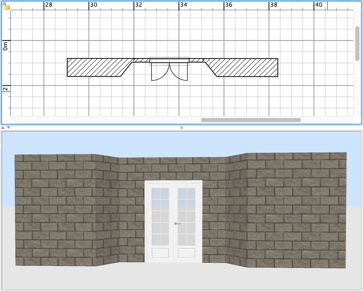

Finally, move the wall part that contains the door to align its exterior side with the side of the main thick wall parts. Once you customized the height and the texture of all the wall parts, you may obtain the result shown in the following image. Don’t hesitate to zoom in your design to work precisely!
adjust recess

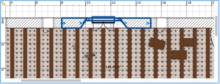

You have two choices to reproduce it in your home. Either you design separately the previous wall parts and insert them in your home at the place you need them. If you already drew the target wall, you may split it twice with Plan > split wall menu item, move the split end walls to the location where you’ll place the recess, remove the wall part in the middle to make an empty space and copy-paste the wall parts and door at that place. Or you may design the house from scratch using this way of doing with smaller wall parts at the places you’ll need recesses. Then just adjust the wall parts directly in your home.
place recess
You might also need to adjust the surface of the existing rooms to fill the empty space that will appear in front of the door. Either remove the existing room and create it again with the room creation tool, or add points to the room with the contextual menu Add point to room and move them at the new corners.

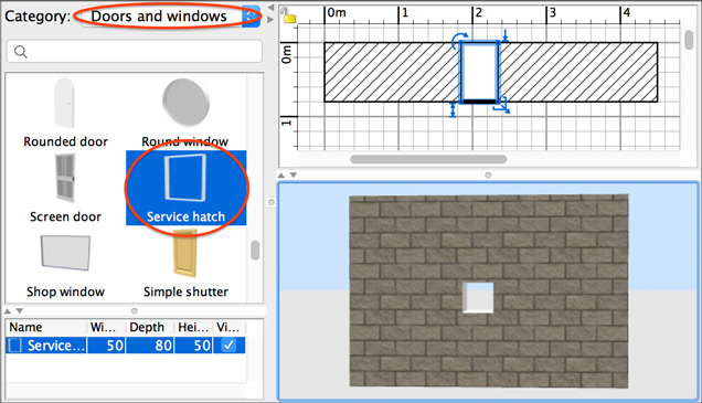

In the furniture catalog, select a Service hatch found in the Doors and windows category and add it upon the wall to make a hole in the wall, like in the following image.
add service hatch to wall

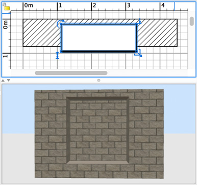

Change the elevation, size and location of the hole to match the recess you want. To create a recess in the wall, move the hatch with the arrow keys or the mouse after deactivating magnetism (permanently with the preferences dialog box, or temporarily with the Alt key under Windows, the cmd key under Mac OS X or the Shift + Alt keys under Linux). As soon as the hatch doesn’t cover fully the wall thickness in the plan, a part of wall appears.
create recess

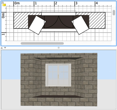

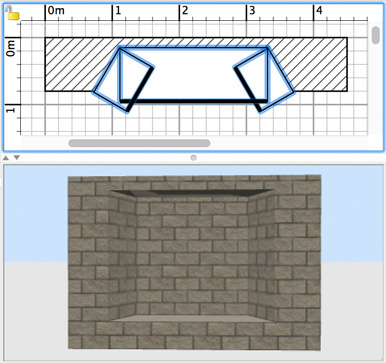

To create beveled edges at the left and the right sides of this recess, copy-paste twice the service hatch, and change the size and location of the copies on the wall like in the following image.
create recess with beveled edges
Drag and drop a window on the wall and adjust its location and depth again without magnetism, to place the window on the wall part not covered by the hatch. You can add also a bench using a customized box.

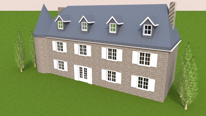

If you’re interested, the final scene of this tip comes from the file Castle.sh3d showing the following nice castle (9.2 MB – designed by eTeks and distributed under CC-BY license). Thanks to OKH for the roof parts used to design it.
castle exterior
