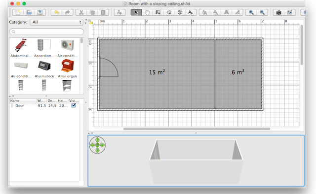

Draw 2 separated rooms:
  • One with the flat ceiling,
  • The other will receive the sloping ceiling.
In our example, we drew first the rooms with the Create room tool and added the walls by double clicking in each rooms. Then, we removed the wall in the middle.
Design a Sloping Ceiling. draw rooms

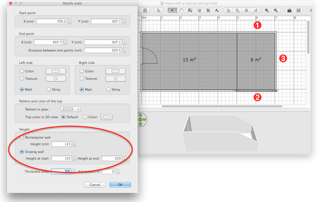

Prepare the 3 walls where the sloping ceiling will appear:
  1. Change the height at end for the wall number 1.
  2. Change the height at start for the wall number 2 (see the picture below).
  3. Change the whole height of the rectangular wall number 3.
Design a Sloping Ceiling. modify walls height

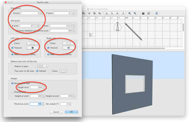

Open a new file and create a simple inclined wall, with an angle approximately equal to the sloping ceiling one.  This will be your sloping ceiling.
Then insert a window in the middle. Here we chose a Fixed window
For a good rendering, you’d better:
  • Choose the aspect of each wall side, especially if you want to apply textures inside the room.
  • Check the height of your wall which should match the length of wall 3 of the room.
  • Check the difference between abscissa X of the start point and the end point : it has to be approximatively equal to the length of walls 1 and 2.
Pay attention because you won’t be able to change this wall, once imported as the “ceiling” object (it is quite difficult to have the perfect result at the first time…).
Design a Sloping Ceiling. prepare sloping ceiling

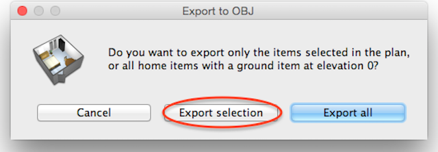

Choose 3D view > Export to OBJ format menu item, enter a file name and when prompted, select Export selection option.

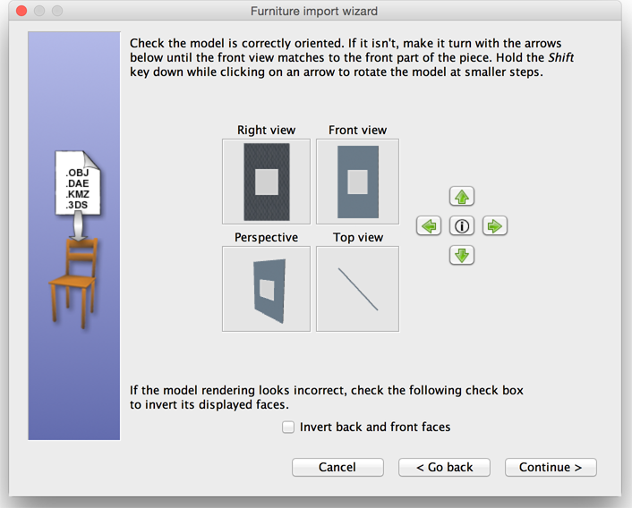

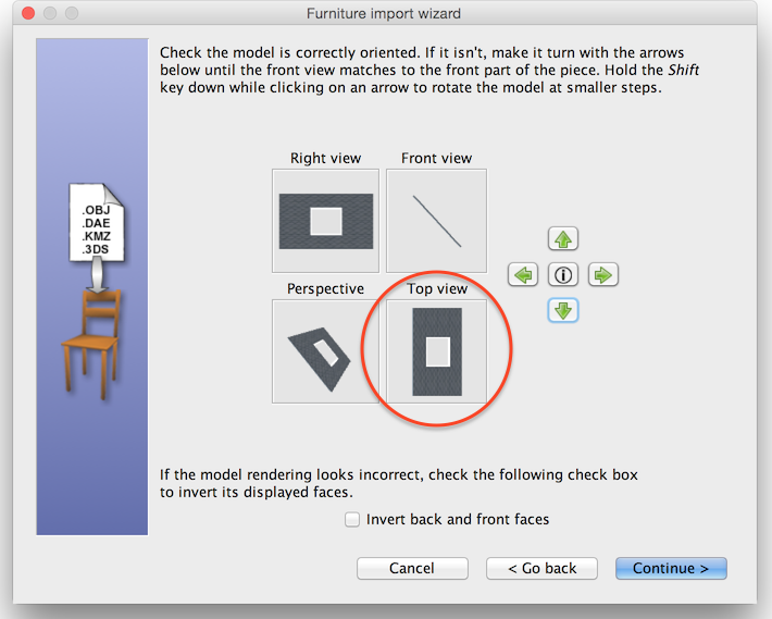

At the second step of the Furniture import wizard, change the orientation of your wall to display entirely the roof side in the Top view
Design a Sloping Ceiling. choose orientation
Initial orientation
correct orientation
Correct orientation

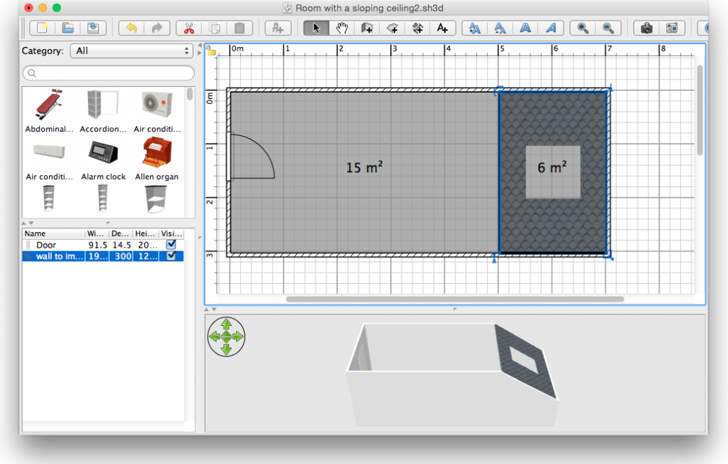

At the third step of the Furniture import wizard, adjust the elevation of your ceiling.
Finally, place your imported ceiling at the desired position. You might have to correct its height to get a perfect result.
To view the ceiling of the main room from bottom, don’t also forget to double click on the main room and select the ceiling Visible check box in its modification pane.
adjust sloping ceiling

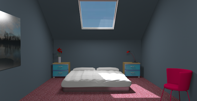

Enjoy your life style under the roof!
Design a Sloping Ceiling. sloping ceiling
