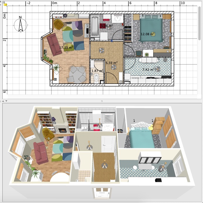

In this example, we start with the first floor of a typical London building (mansion)
Let’s consider you need more room and plan to add a basement.
This tip shows how to design this new underground level and reconsider the whole house.
