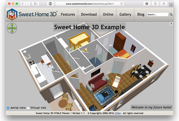

The button shown in the viewHomeInOverlay.html will display the 3D view in a pane that covers 90% of the browser window like the following button does.
The HTML canvas shown in the viewHome.html file will display directly the 3D view in a web page like the canvas shown below.

That’s the reason why I added a new service to sweethome3d.com web site that allows registered users to upload their .sh3d files to view them in 3D in their browser, with a title and a comment like in this example and in the screen capture shown below.
example

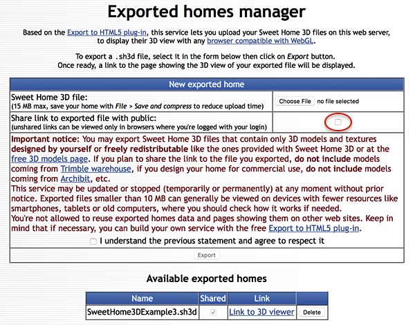

Once the web server has received your .sh3d file, it simply applies the Export to HTML5 plug-in on it and returns a link to a web page that displays your home in 3D. If you want and if your .sh3d file contains only 3D models and textures that can be freely redistributable, you may share the returned link after selecting the Share link to exported file with public option displayed in the Exported homes manager page shown below when you’re connected to the new service.
exported homes manager

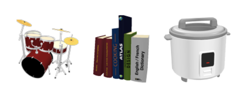

My very first goal during the development of SweetHome3DJS project was to be able to display 3D models at OBJ + MTL format with WebGL. This ended to the “surprise” published for Sweet Home 3D 10th birthday which displays in 3D one of the examples of the gallery exported to OBJ format. This ability to interpret OBJ files was needed to display the furniture contained in the homes exported with the Export to HTML5 plug-in. But this feature still can be used alone to view in 3D a model at OBJ format, like the ones available in the free 3D models page. Therefore, I changed all the links on the images showing a 3D model in that page to make them display that model in 3D when the user clicks on the images, like in the examples below. Hope you’ll like this bonus!
objects
Making this change helped me to program a robust OBJ file interpreter than I could test with many different files, but also helped to discover that many models of the free 3D models page needed some fixing, either because some of their faces weren’t correctly oriented, or because their file was uselessly too large. Such corrections were applied to 115 models that you can also find in the version 1.6.2 of the SH3F furniture librairies released a few days ago.
