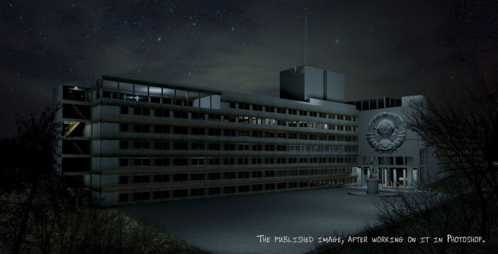

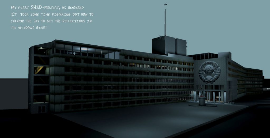

In 2012, I published a 14-chapter serial on my blog something I called a blog-adventure — not at all serious — but it needed illustrations. That was the first time I used Sweet Home 3D seriously, and I spent hour after hour searching Sweet Home 3D forum and reading about other people problems and how they were solved, trying to learn as much as I could about the program.
This is one of my first illustrations made with Sweet Home 3D:
first sh3d project
I knew very little about Sweet Home 3D at that time, so the final result includes a lot of Photoshop-ing:
first sh3d project finished

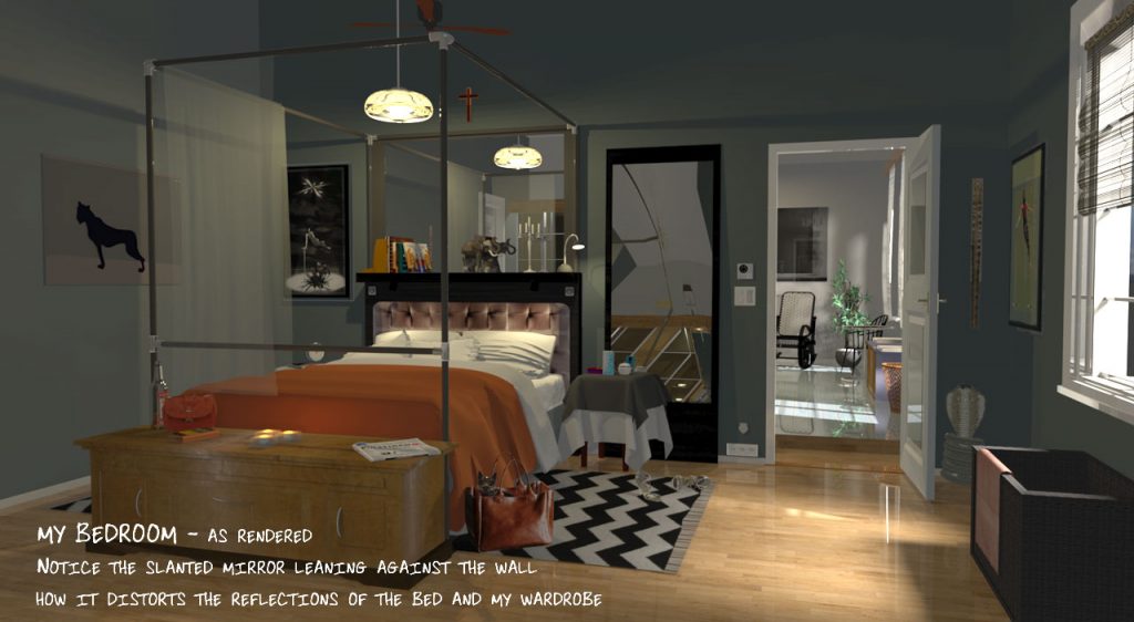

Then I got the opportunity to buy an old shack just outside Copenhagen. With my better half still studying in Miami, I needed a program that could visualize my ideas for remodeling and furnishing. So I modeled the complete house and furnished it, and sent the pictures to Miami for approval and input.
This is my proposal for decorating the bedroom:
bedroom decorating

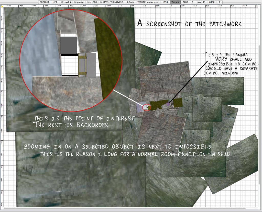

My landscapes are constructed from multiple terrains with variable surfaces and heights.
terrain in patchwork

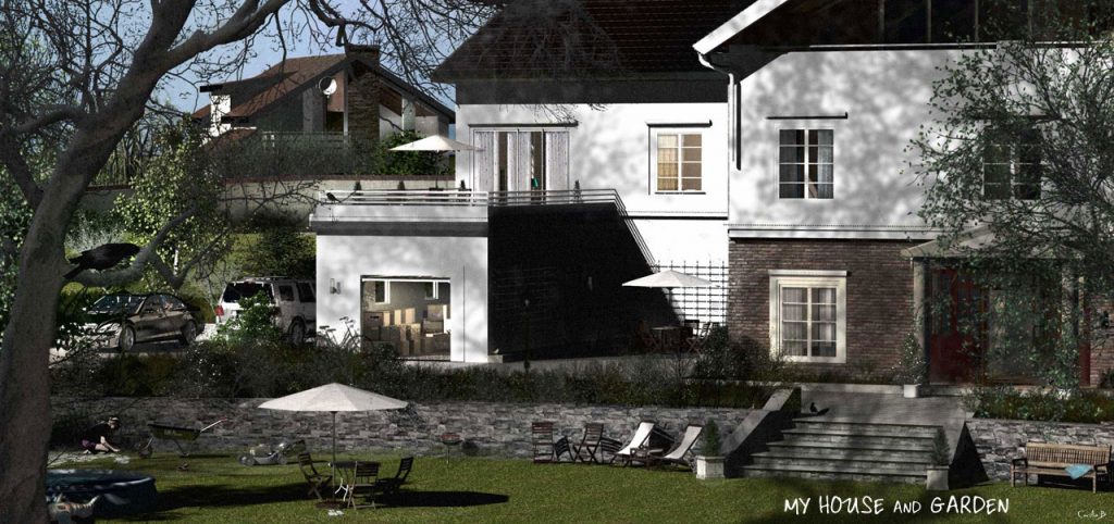

I create most of my big terrains using Vue partly because it’s a program that is easy and intuitive to use, but mainly because of it’s enormous library of textures, and the way you can design your own textured fields in millions of combinations, so you can avoid having a landscape that looks like it’s been tiled. But the bigger terrains are really best for faraway hills and distant mountains, and Vue’s textures can be also exported and used on smaller terrains.
For smaller terrains, like terrains close to buildings or when I need more accurate details, I use Verto Studio 3D. With this application, it’s easy to create like caves or tunnels, and overhangs, but its also very easy to create uneven surfaces, like a forest ground, a lawn or a gentle slope with random irregularities, like around my house:
house and garden

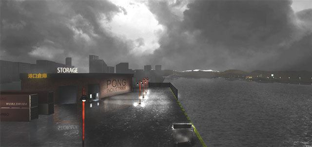

The stills, in the first part of the film, are all original renders from Sweet Home 3D. Color-correction is, however, performed on one scene, after discovering that I had forgot to remove a blue filter from the surface of the water. This is the original:
still with blue filter
The scene is made from 5 different renderings, and instead of rendering 4 new images, I replaced the blue with grey.
still corrected

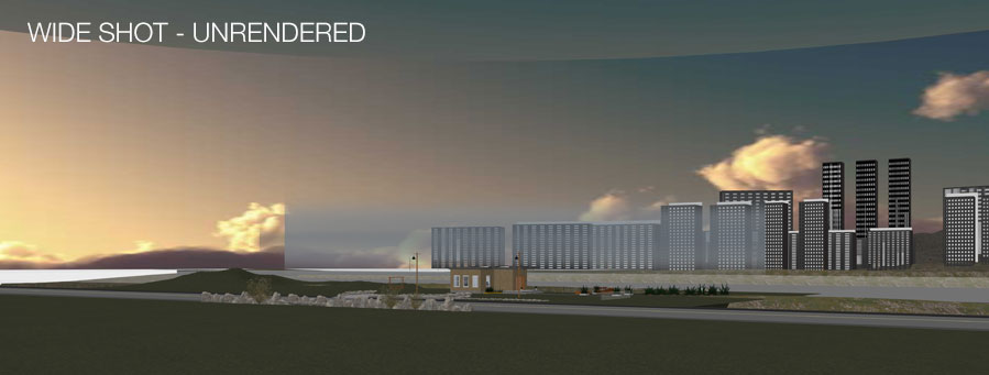

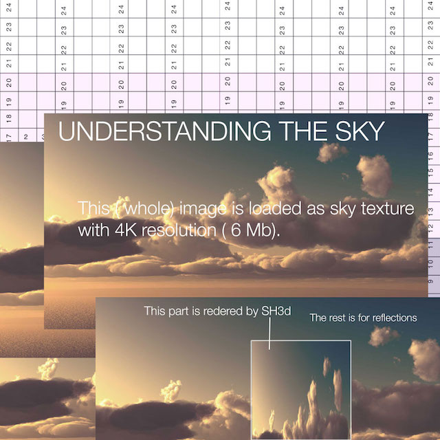

Here’s an example on how I’m texturing the sky. First I find a nice picture, or I make one:
evening sky
Then I match it to the visible area of the sky, using a matrix that gives me the right coordinates of the equirectangular projection.
understanding the sky
wide shot unrendered

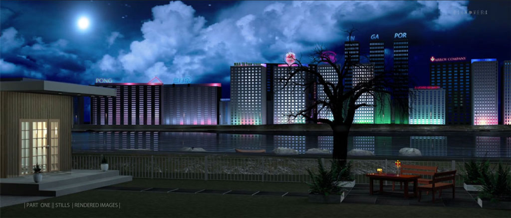

Sure. This is a rendering. I’m not saying that everything in this picture is made with Sweet Home 3D, but neither are the 3D models that comes with the program. The tree, for instance, is a PNG. of a Photoshop-brush, and the neon signs are 3D models made with Photoshop, using 3D extrusion and exporting them as OBJ files. Afterwards I edited the MTL file to add the glow effect. Shining different colored light on them, they stand out as glowing with different colors in the dark. The moon is a glowing sphere with a semi-transparent fog placed in front of it to diffuse the light.
The “ghost city” itself, is just a backdrop, made from boxes in horizontal and vertical rows. Use copy/paste, and it will take maybe five minutes (things don’t have to be big to look big, it’s just a matter of perception whether things appear to be big or small).
It took some time rendering it: 8 hours on a 12 core Mac Pro.

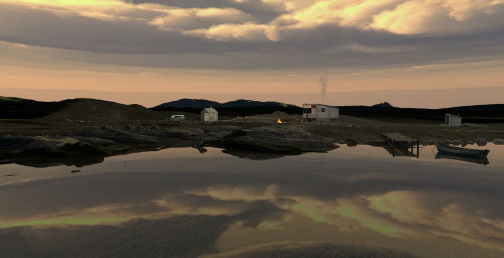

In the first part, the terrains and the skies are made with Vue, and imported into Sweet Home 3D. I have added some birds and some specs of dust, some rain and a lightning effect, trying to bring some life to the stills, and I have created camera movements, zooms and panning, with After Effects, for the same reason. I only zoom between 78% and 100%, and all the images are rendered in 2K.

  1. The zoom function is next to useless when using a touchpad or a magic mouse, since the program cannot zoom in on neither a selected object, or on the camera.
  2. You have to zoom in on the camera to control it. It should really have separate controls, totally independent on how far in or out your work area is zoomed.
  3. Objects cannot be moved along the z-axis with the keyboard.

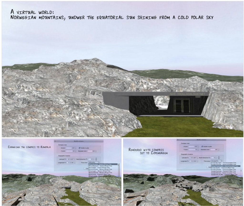

And in the next location (which I am working on): A cave exploration in the Norwegian mountains accidentally leads to finding a hidden entrance to an enormous abandoned military bunker from the Cold War, one hundred meters under the ground. It looked good on paper, but when I had constructed it, I started to realize where the water would end up every spring when the thaw started. So the story had to be changed, and the many hours of creating tunnels and constructing the underground labyrinth, was in fact saving me from making a mistake.
norwegian mountains

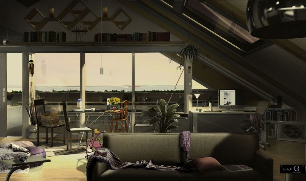

attic
