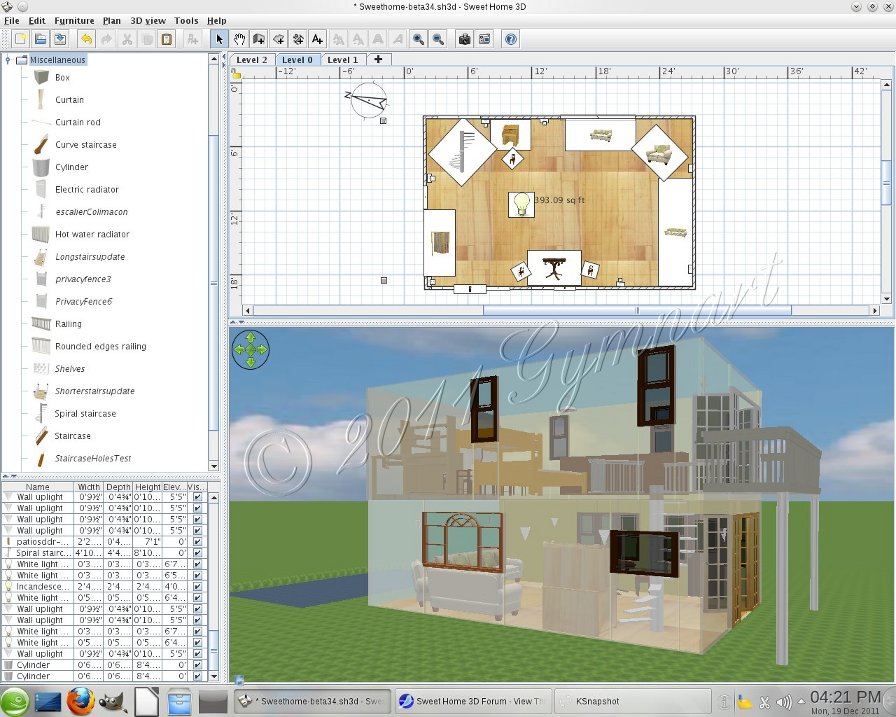

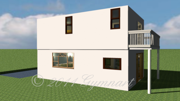

Re: Sweet Home 3D 3.4
Great work Emmanuel!
I made a swimming pool in the back yard of a house I'm testing. I also made a "basement" but it's more like a crawl space. You can't see it unless you go down there.
I'm attaching snapshots so you can see.
