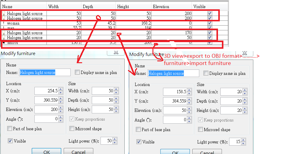

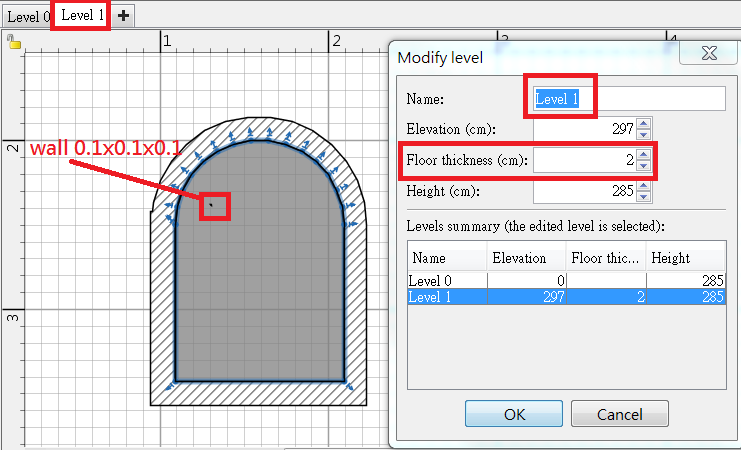

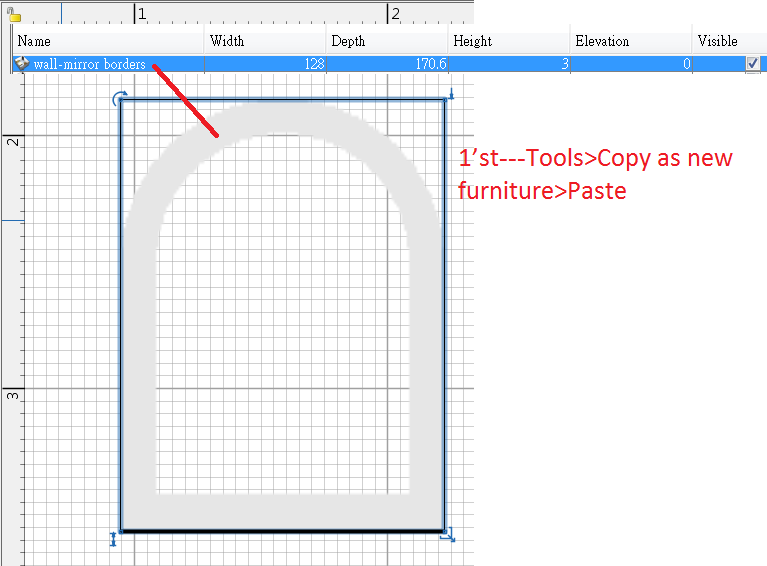

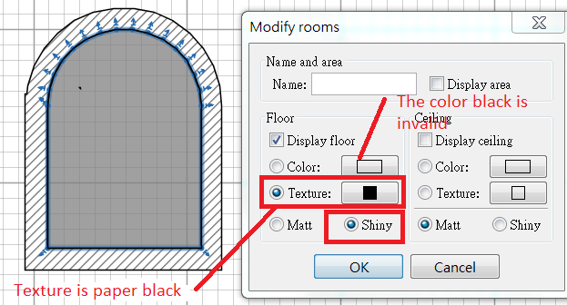

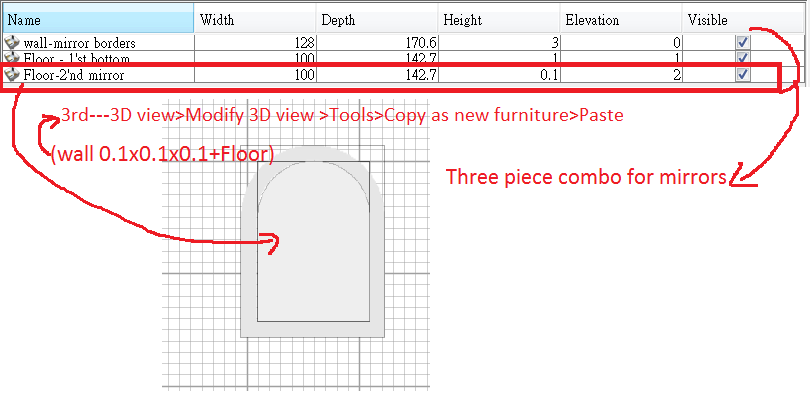

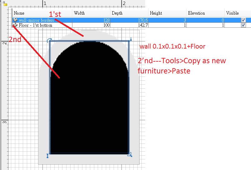

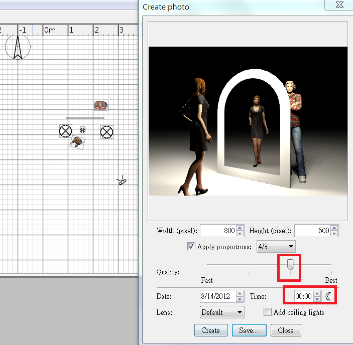

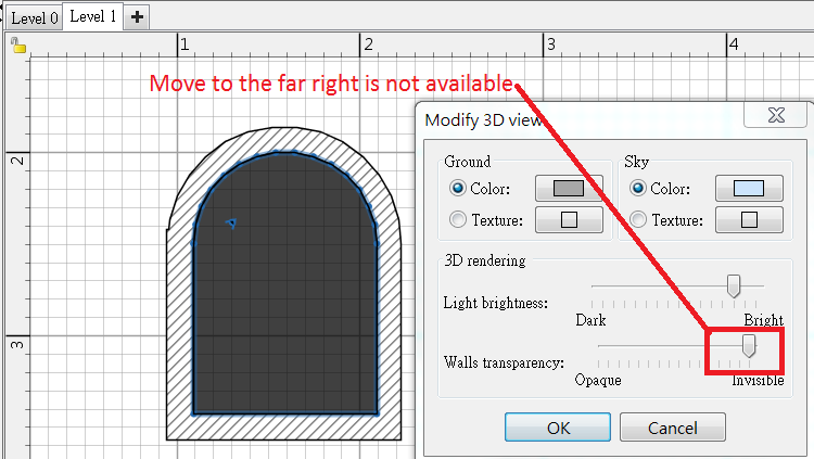

My steps are as follows:

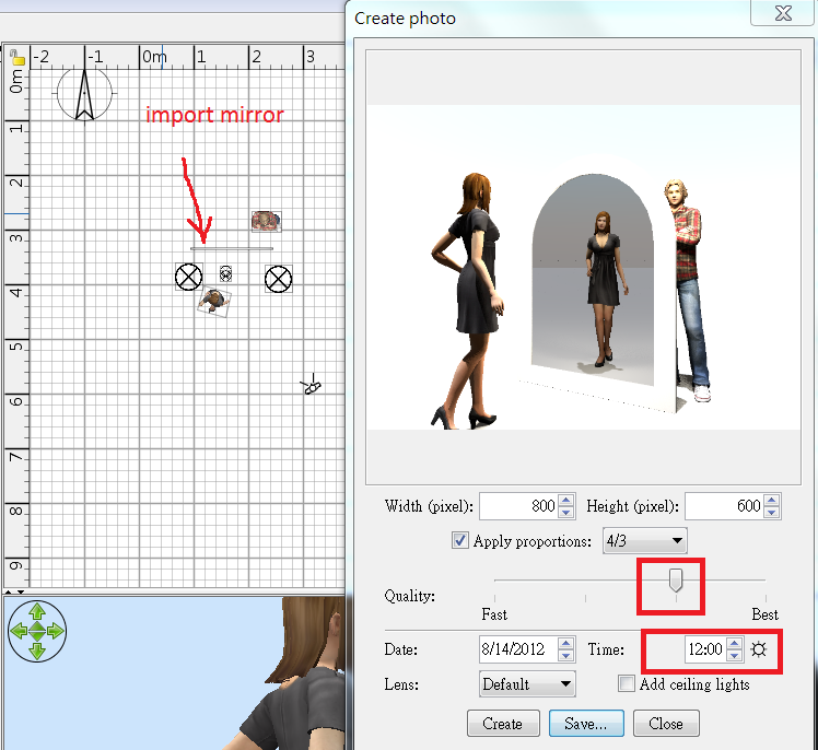

sclee, thank you for the tutorial, I really tried to do my best. But the result is not goog as you can see on my picture:
I think that I was made a mistake somewhere, but where is it? [:-/] I'll try to find, becouse I need a round mirror and some types of different-shaped mirrors...

Post by Puybaret »
As explained previously, the "full" mirror effect can be obtained only for OBJ parts starting by sweethome3d_window_mirror. If you want to do it with Sweet Home 3D, this implies that you'll have to use Export at OBJ format, rename the mirror part in the OBJ file then reimport the modified OBJ file.

Puybaret, yes!!! I made this! I changed the OBJ-parts as you advised and I made the mirror [:D]
Here is the result:
Many thanks to you and sclee!
