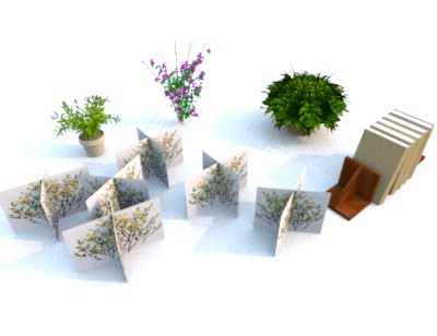

I also had alot of problems with the DAE files, so I investigated a little on my own, and since of course I'm not much of a programmer, I don't really know if what I suspect is correct, mainly that DAE assigns most textures as two sided. Is this correct? When I "fixed" google dae , I always reversed the faces and made sure both faces had the same texture. I don't know if this was accurate, but it seemed to work. But I am trying out the new version, and would bow to you as a god if this new version makes trees and plants easier to import.

Re: Strange behaviour from DAE-import
Chris, I had only problems with the 4th one (grass) under version 2.5, but even this one seems to work now in version 2.6 Beta. As expected and seen in the joined image, the grass is not rendered correctly with SunFlow because it doesn't support transparent textures.

Hmm, maybe the books is just my graphics driver then. I did update it, but I'll have to ask around about any known issues with rendering.
I haven't tried importing in 2.6 yet, so I am glad that you kind of paved the way, lol. The plants froze my version of 2.5, but if I am having trouble with my graphics driver, maybe it is due to that also? My video is ATI Radeon hd 4350. Do you know of any issues?
